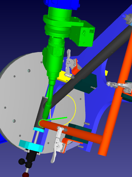

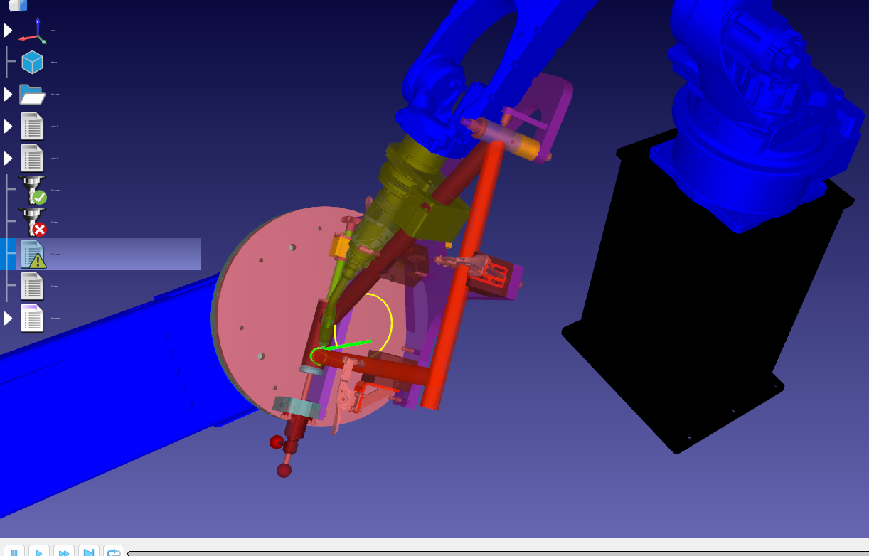

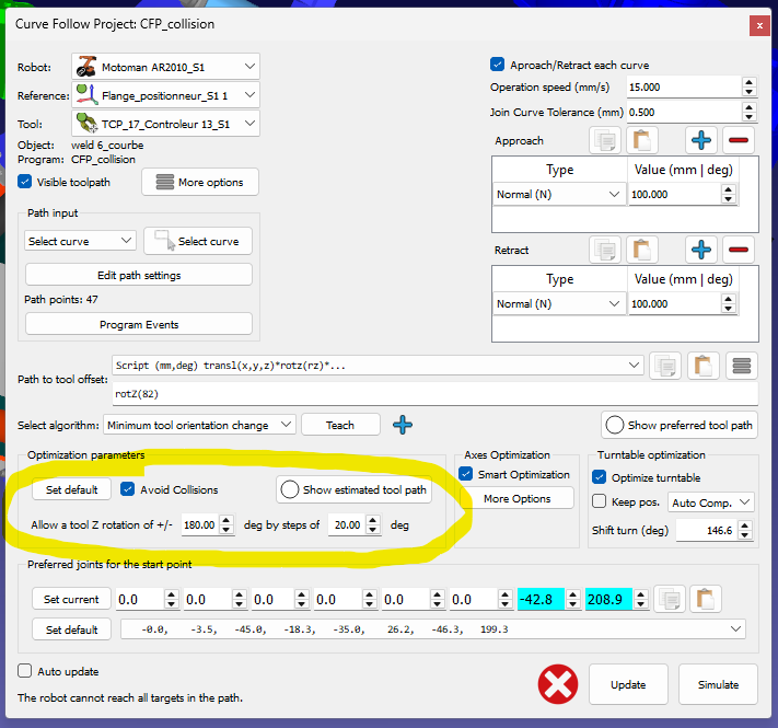

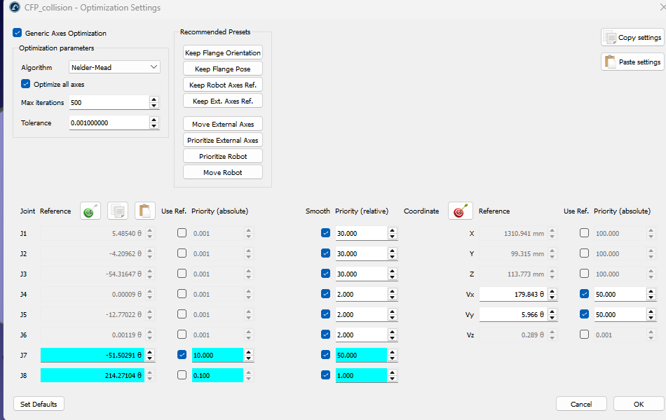

I am working on a project for bicycle frame welding. I am extracting geometries from Rhino Grasshopper to RoboDK either as targets or as curves. I wanted to use CFP in order to smooth have curves with IJK to permit a 180 deg around the tool but I have some issues using the avoid collision option.
You will find attached the RDK file with the cell.
The first CFP creates very smooth motion without big joint jumps but with a collision on the tool (photo : Collision_welding_torch.png)
The second CFP on the file has the avoid collision tickbox checked but doesnt converge to a solution (stops before the collision).
The third is a manual program I did using joints target from the first CFP program and manually adjusting the orientation of the torch on the last points to avoid collision. (photo : No_Collision_welding_torch.png)
Is there something I have done wrong in the parameters of the curve follow project ? Is there a better way to achieve the result from the 3rd program using CFP ?
