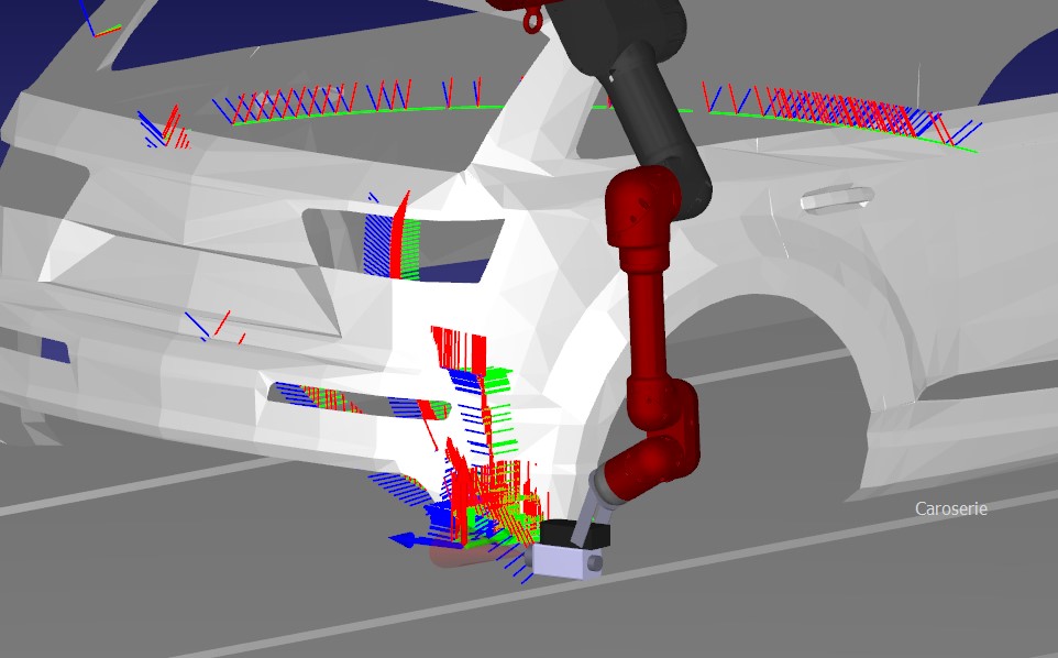

Hi, I wanted to point out this bug. See attached.
Still appears after PC/App restart. At some point it gets annoying.
Ionut
Hi IonutF,
I think you might have pressed "Alt+T" by accident.
This will activate the TCP trace.
"Main menu"->"Tools"->"Trace".
You, Sir, are a genius. And I salute you for that.
Though, I would recommend you do something with this option in the future - if you have the power to do it. After the software reinstall, the option was still enabled.
As a new user, my expectations are to have everything on Factory settings.
Thank you once again.
