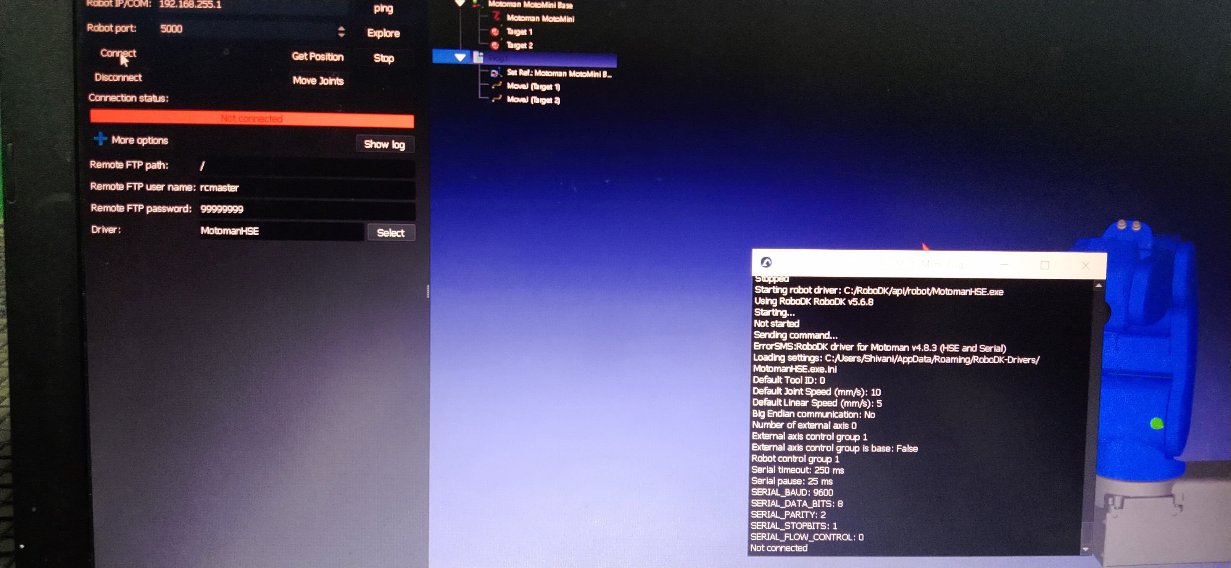

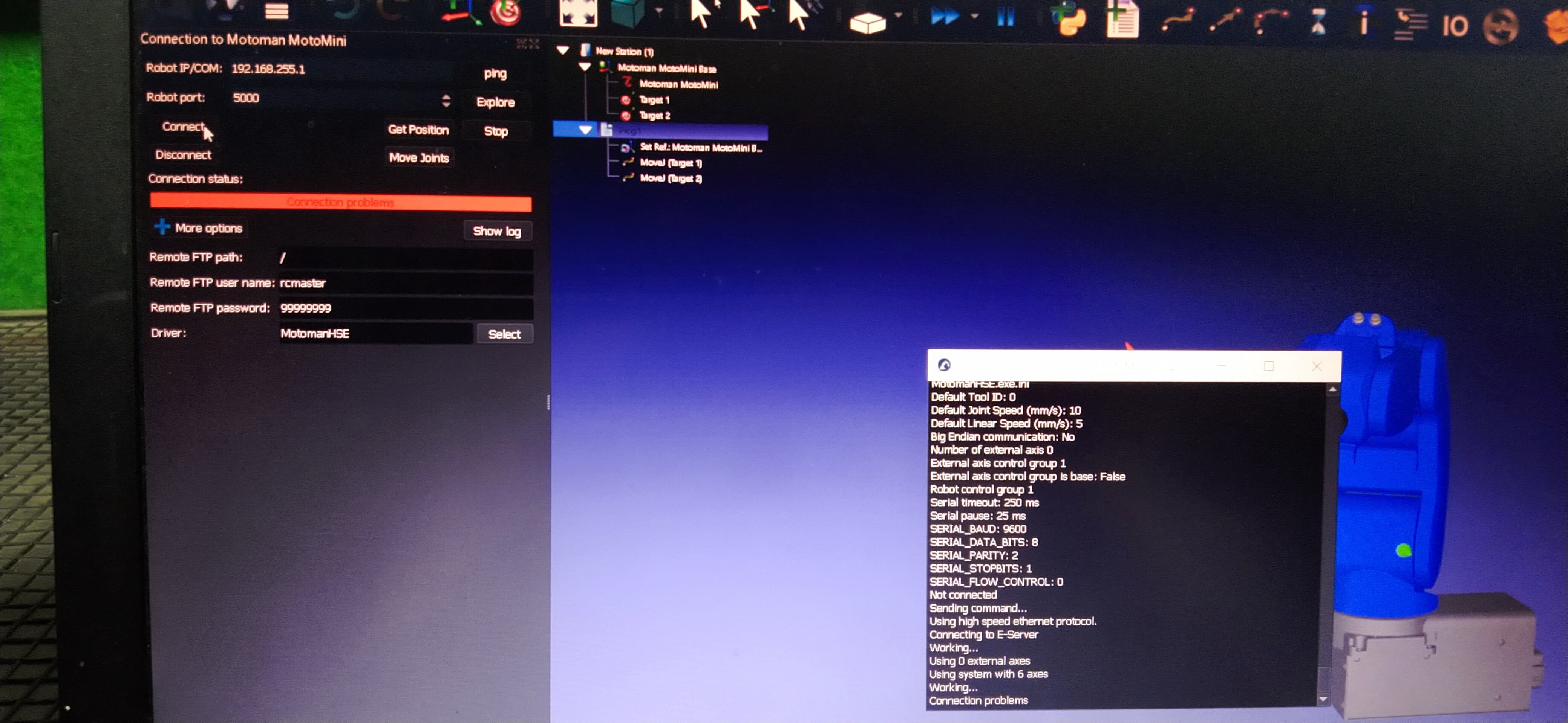

We are trying to operate the Yaskawa Moto Mini Robot with RoboDK software. We found the IP address of robot on teach pendant but now struggling to find the port number of Robot. where we can find it?
As per the RoboDk document I found on the internet that the port number for Yaskawa robot is not so necessary to connect with RoboDK. can you please clarify whether it is necessary or not?
I tried with your Yaskawa MotoMini robot attached whose pulse/degree parameter is already defined. When we are trying to connect robot with RoboDK we are receiving the attached problem please provide the solution on the same.

You should not change the port used for the communication between RoboDK and the Motoman MotoMini controller.
Did you properly establish the local network? Are you able to ping the robot? Are you able to connect to the robot using an FTP client such as FileZilla?

Yes, we tested with the same credentials, as can be seen in the previous screenshots.
