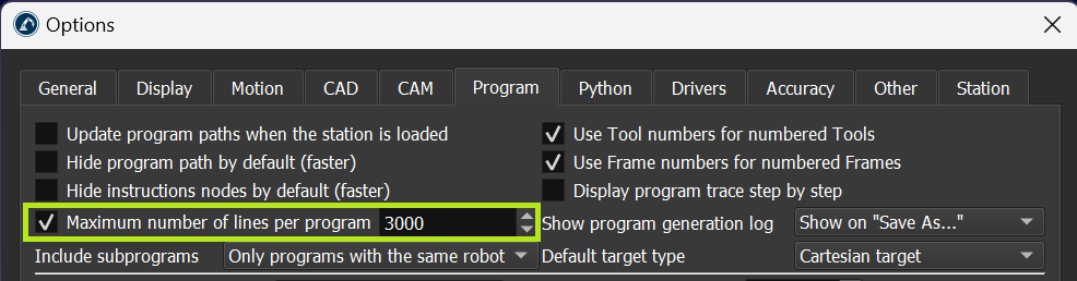

I need again help to solve a problem with machining programme ,it has more that 9999 steps, any solution to solve this problem, The error that i had is Alarm 4202[19]
Thank you

You can split a large output program into subprograms by using the Tools - Options - Program - Maximum number of lines per program :
#16
I split at 2000 Lines. That is just under 500k of code which is the limit of at least my controllers.

Thank you for your feedback. We'll update RoboDK soon to output programs for Motoman always in upper case (the file name, the name tag inside the program and JOB program calls).
