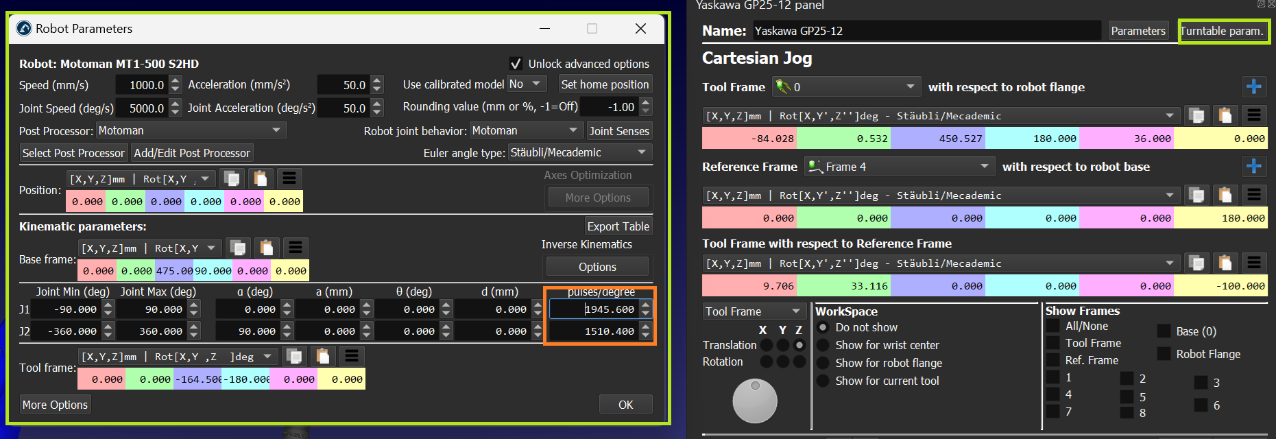

Found some number on the tp with pulsedata. For those interested Motoman MT1-500 S2HD pulses/degree:
j1:1945.6
j2:1510.4
You can manually enter the pulses/degree values for the external axes (rail, rotary table, etc.) in the rotary table parameter tab on the robot control tab that appears when the external axes are synchronized with the robot.
