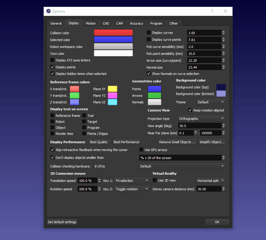

After a while using the zoom in orthographic mode the camera reacts weird.
The near plane changes automatically (the value raises) and we cannot zoom correctly on the oject.
It seems that crossing objects and deep zoom unset the near plane value.
When we go back to perspective mode. No more problem.
Here after a video and my scene

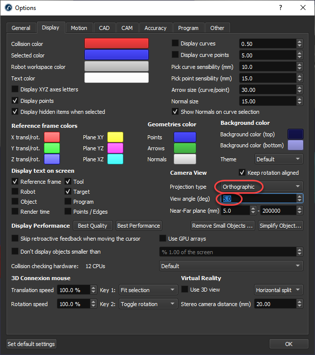

To be able to zoom in clooser without plane clipping, I recommend you to change the view angle from 30 deg to 5 deg as shown in the attached image.
(04-24-2020, 11:08 AM)Albert Wrote: To be able to zoom in clooser without plane clipping, I recommend you to change the view angle from 30 deg to 5 deg as shown in the attached image.
It's the same problem when I zoom too deep, the problem arrives later but it arrives.
