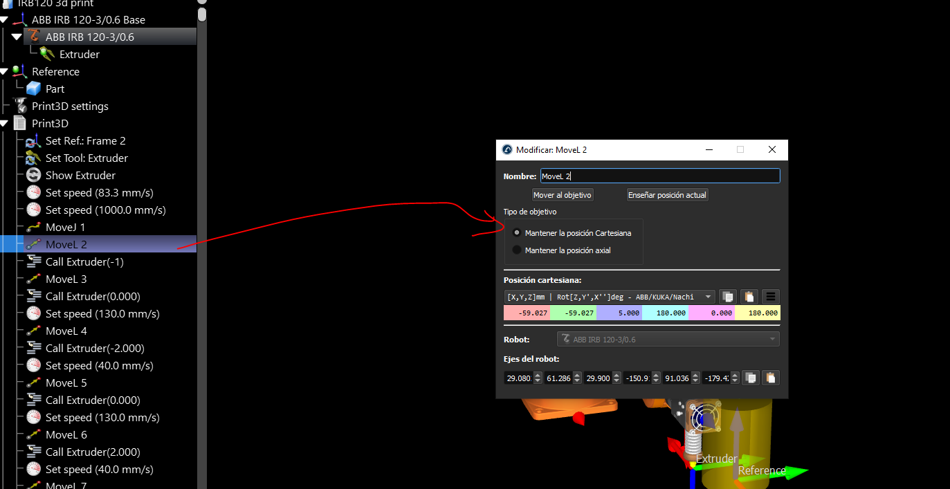

We want to generate a program from the c # api with more than 100000 points, we know how to generate it, but every time we add a point, it is added to the Tree and this slows down the program, we would like to add the points (from the c # api) as shown do it automatically with a machining program (with hidden points in the tree)
Can be done?

UPDATE_:  I see the instruction ShowInstructions, it's work well, the main problema is that i need to generate a target and after it atacch to the programa, is possible to atacch directly to the program without create a target, or create a target but don't show it in the cell ( to avoid the time to create 200000 target and show it?)
This kind of object, movj without target associtate, can i do it from c#api?
