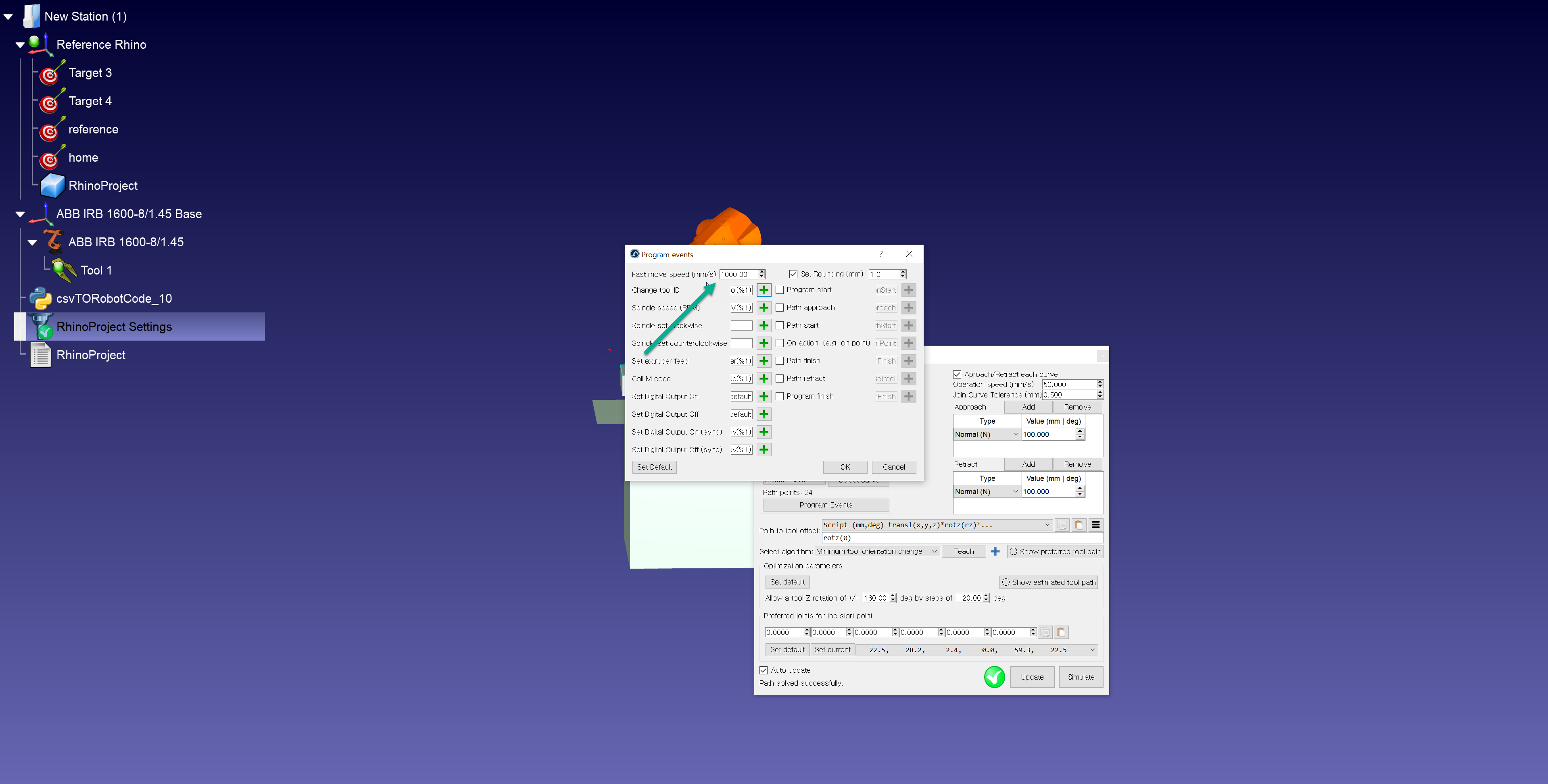

changing default speed in Project setting
All i want is to change this 1000 to 100 in default,
please send me the process if possible!!
i have a license, so send me if i need a post-processor also because i cannot edit the code from robodk.

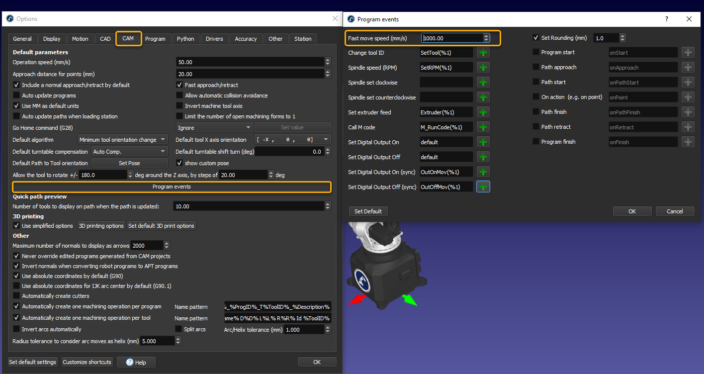

You can change this setting here:
