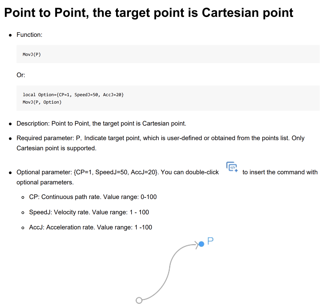

I noticed there was an issue when generating joint moves. You should provide joint values, not the pose. I attached the post processor with some minor edits.
.py   Dobot_MG400.py (Size: 21.67 KB / Downloads: 840)
How ever I found the joint move <MoveJ> should provide cartessian point instead of joint value.
I think the joint value should apply in <JointMoveJ>.
With the information you provided it may be more robust to use an absolute joint movement for joint moves (the MoveJ function in RoboDK post processor)
Also, it may be better to not specify the arm orientation for linear movements.
I attached the updated post processor.
.py   Dobot_MG400.py (Size: 21.88 KB / Downloads: 1,098)
