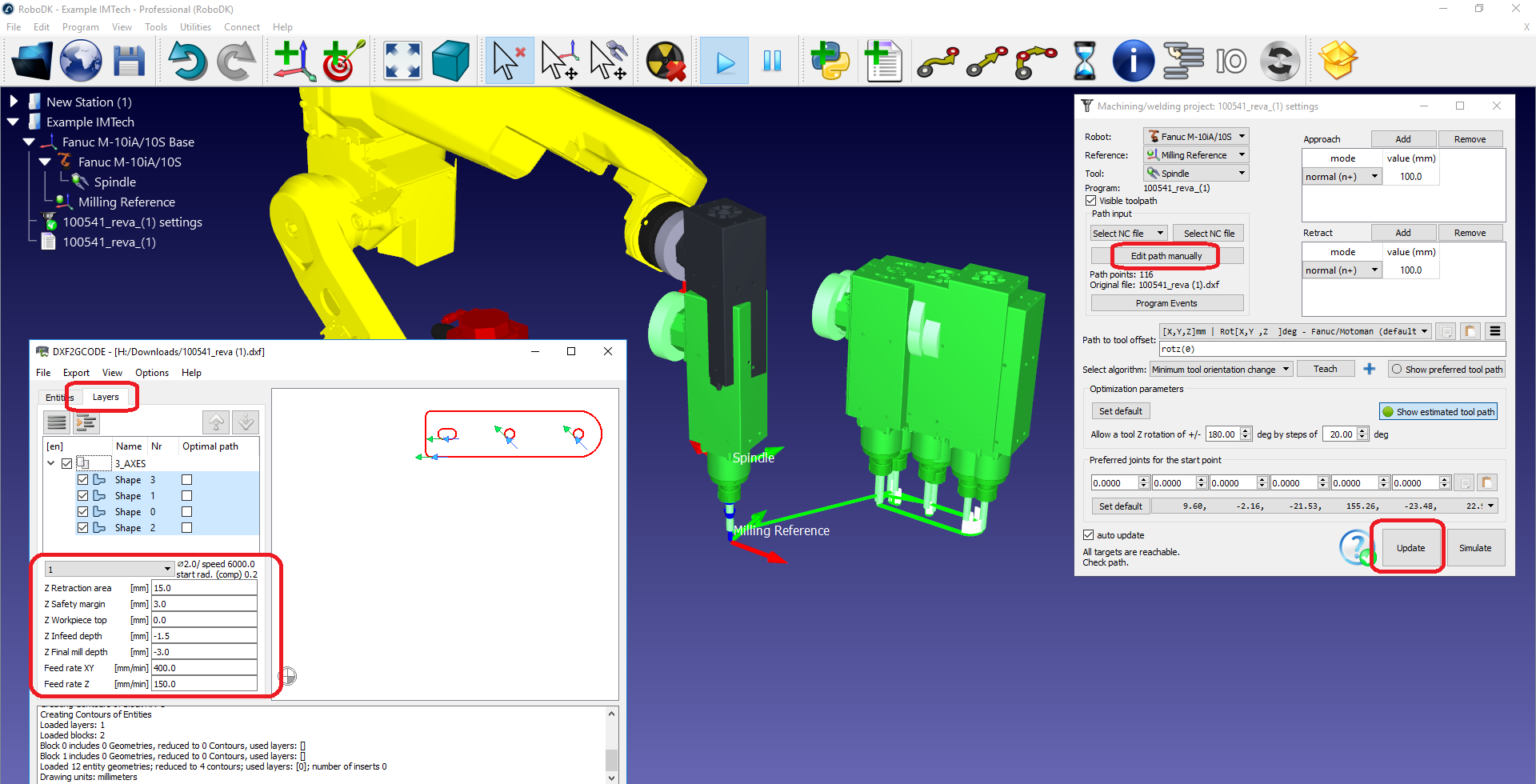

If you are using the DXF2Gcode app to import DXF files you'll find these settings in the Layers tab (XY speed/feed rate and Z speed can be set separately).
Behind the scenes, a G-code program (machine code) is generated from the DXF file and loaded in RoboDK as if it were a normal G-code program. The G-code program includes speeds and tool radius compensation so you may need to account for the tool diameter as well.

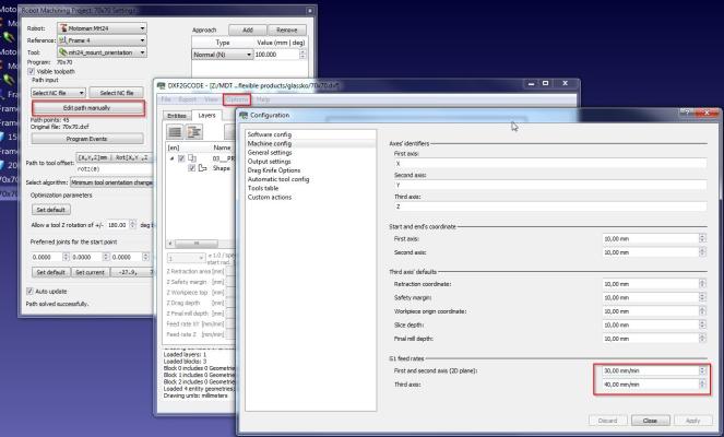

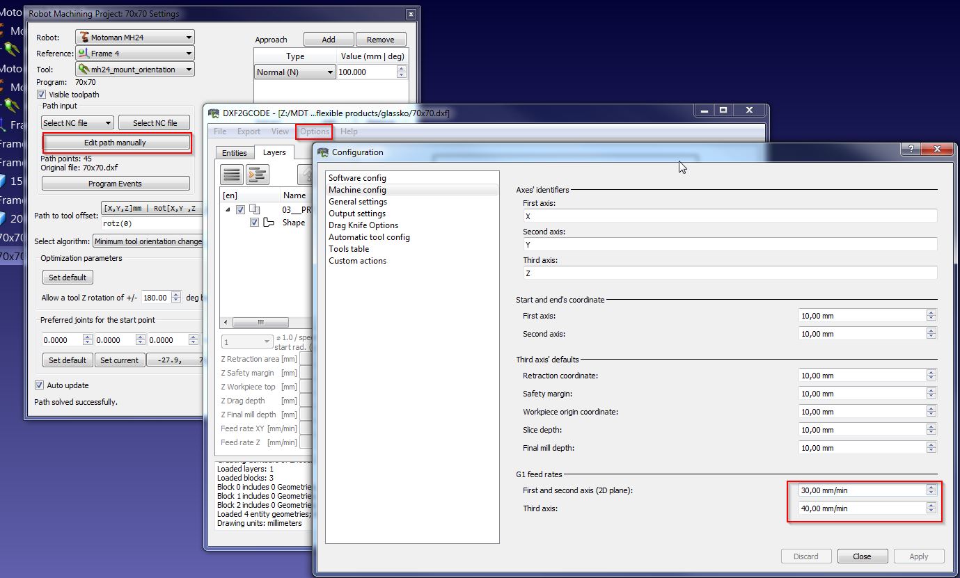

I would assume that when changing the speed setting the program would use these new settings after pressing update. Instead I need to delete the program and the "robot machining project" completly and import the dxf again. When creating a new program it has the new speed settings.
I go here to change the speed

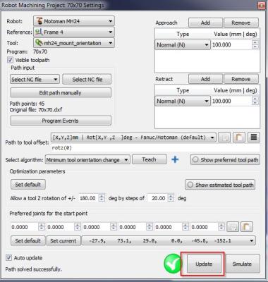

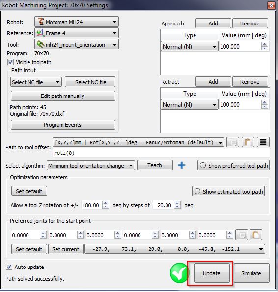

i then close the windows and press update
I hope I'm doing something wrong because this is not ideal.
