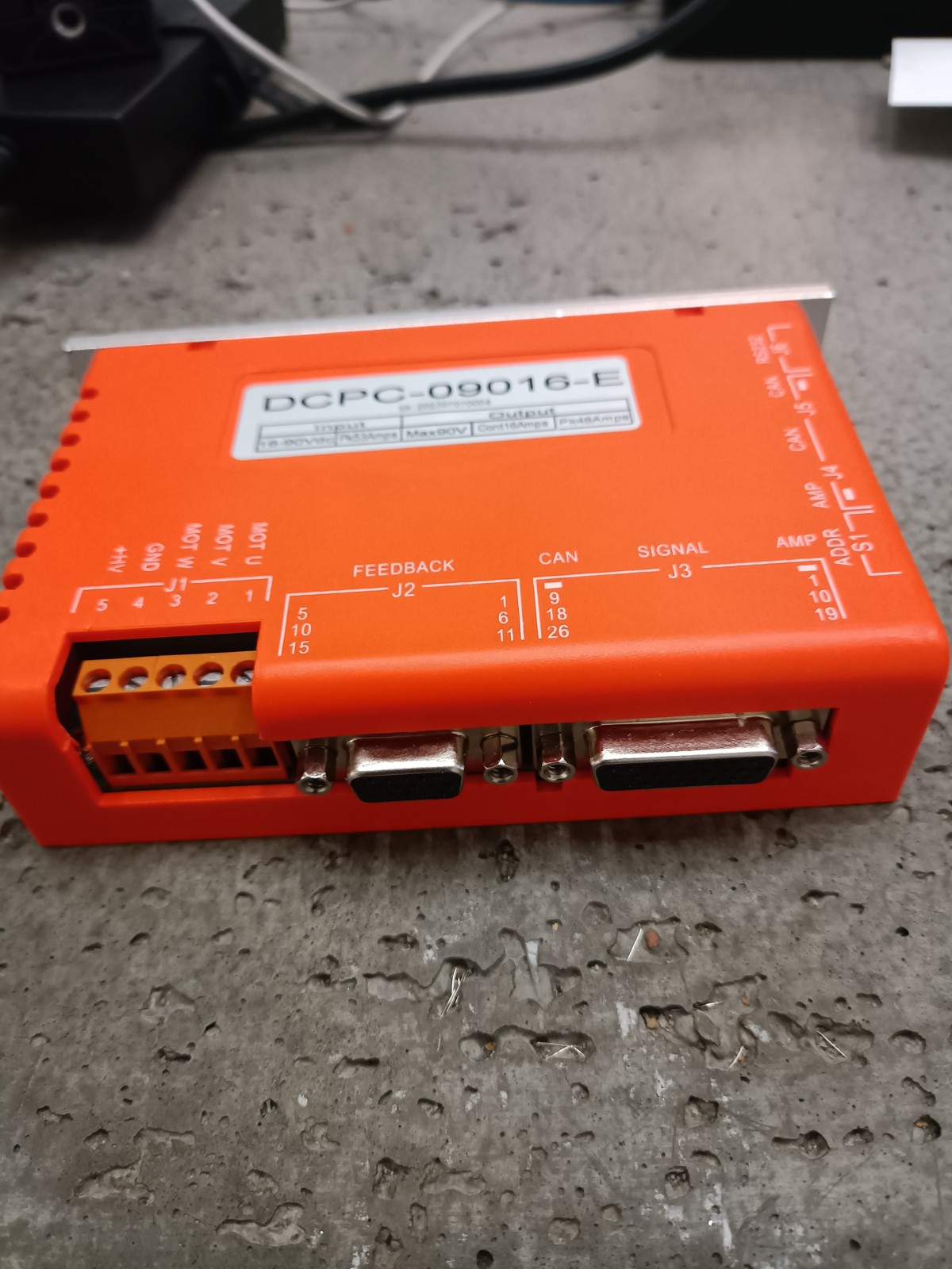

I'm working on a project integrating a servo motor with my cobot and vision system in RoboDK. I have the motor driver, but I'm facing difficulties setting it up for communication with RoboDK.
The challenge is that the driver uses CAN bus communication and cannot be assigned an IP address. I'd appreciate any insights on the best approach to connect and control this driver within RoboDK.
I am attaching the datasheet for the driver for your reference. It contains detailed information about the driver's specifications and communication protocols.

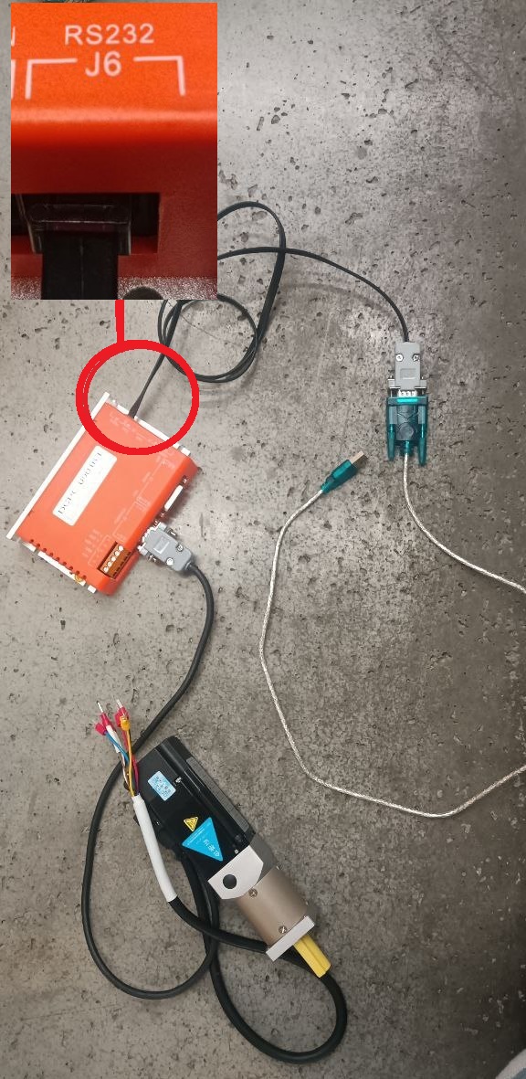

We use robots from Elite Robot Company. We want to control a height adjuster (using a servo motor) that adjusts the cobot's height independently within an integrated RoboDK system.
Thank you for the two solutions you provided. Regarding the first solution, we would prefer not to use the cobot controller to maintain independence between the height adjuster and the cobot. The second solution involves using a converter like USB-to-CAN or Ethernet-to-CAN. However, the attached image shows that the driver can be connected to the computer via the converter using an RS232 connection. Is this connection method appropriate for communication with RoboDK? In fact, can external devices with USB ports be controlled directly by RoboDK software?
Do you have an example of code or a video to connect an external device to RoboDK software?
The driver manual file was too large to attach.
The code example you mentioned is an example we provide as a reference for connecting to robot controllers or other devices:
https://robodk.com/doc/en/PythonAPI/driv...er-example
Alternatively, you can create the necessary control code using the Add Python Program and use it in a program sequence using the Program call instruction.
You can use the PySerial library for serial data transfer.
