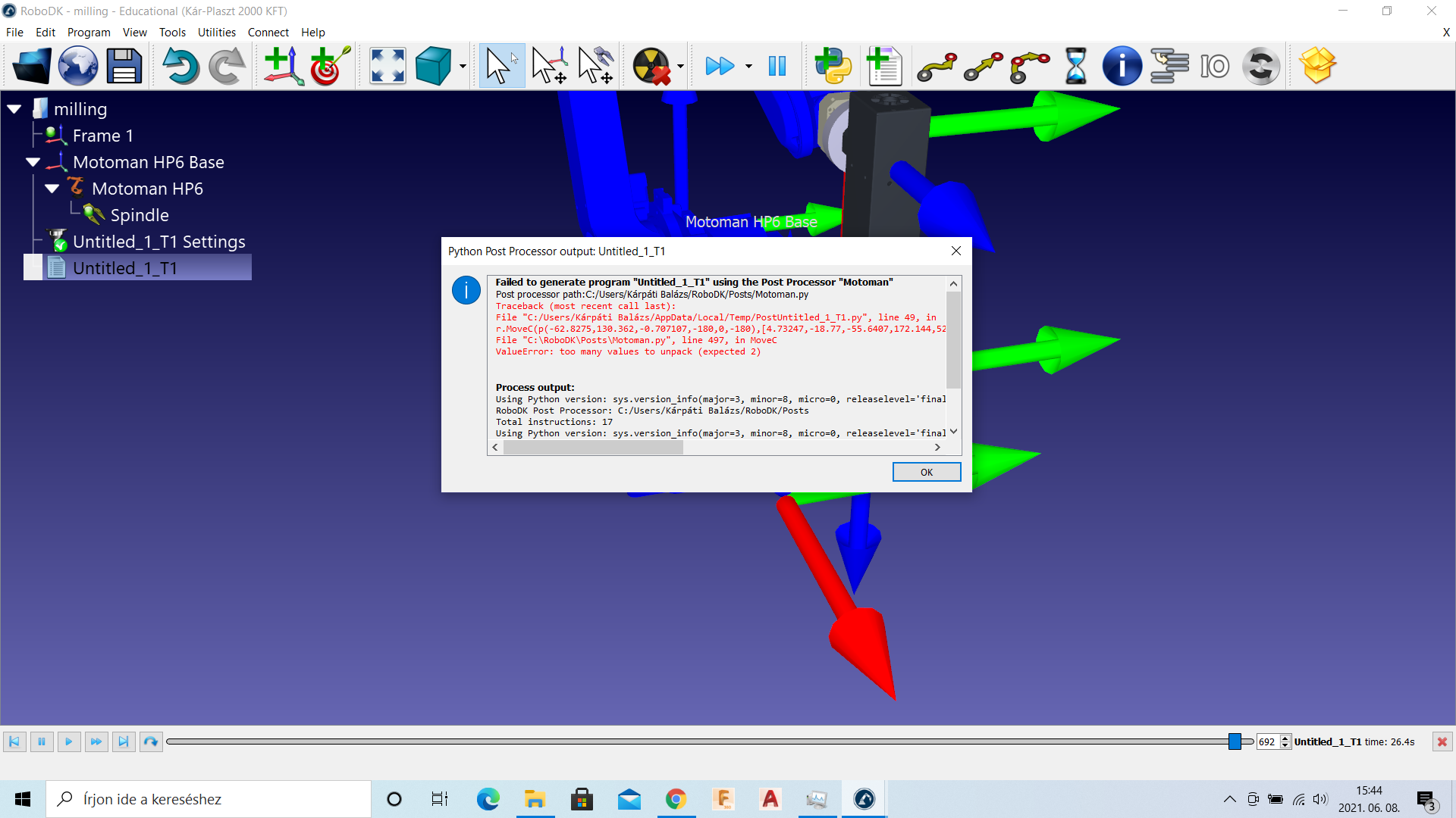

I bought the student license today and when I send a shit track from the fusion 360 program to the robodk it also shows up but when I want to generate a program from it that I can then use on the robot then I can't generate a program.
I will also send the program and the error message.
Thank you in advance for your reply.
.rdk   milling.rdk (Size: 1.59 MB / Downloads: 738)
I am sending you the Post Processor in reply to email you sent me. You need to paste the PP in the Posts folder under C:\RoboDK\Posts
It should work then.
