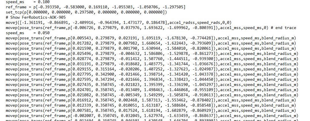

Something else I am curious about is now, when I generate the program, most of the moves are assigned the correct blend radius, (the variable name) but the approach and retract is assigned a blend radius 0. Is this a default setting I can change? The blend radius is assigned a value before this move but it is still set to 0 in the command for the move. I have attached a screenshot of the script that was generated.
This is a default setting you can't change.
But I take note of this for the next release.
