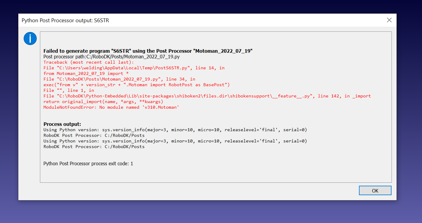

Today we have encountered one error while generating program using RoboDK. It is showing something wrong with the post processor python script.
We have just installed Version 5.6 of the RoboDK.
I have attached a picture of the error.
Can you please help us rectifying the issue?
It looks like you created a custom post processor (Motoman_2022_07_19). Can you provide it so we can better investigate? You can upload it as a ZIP file.
