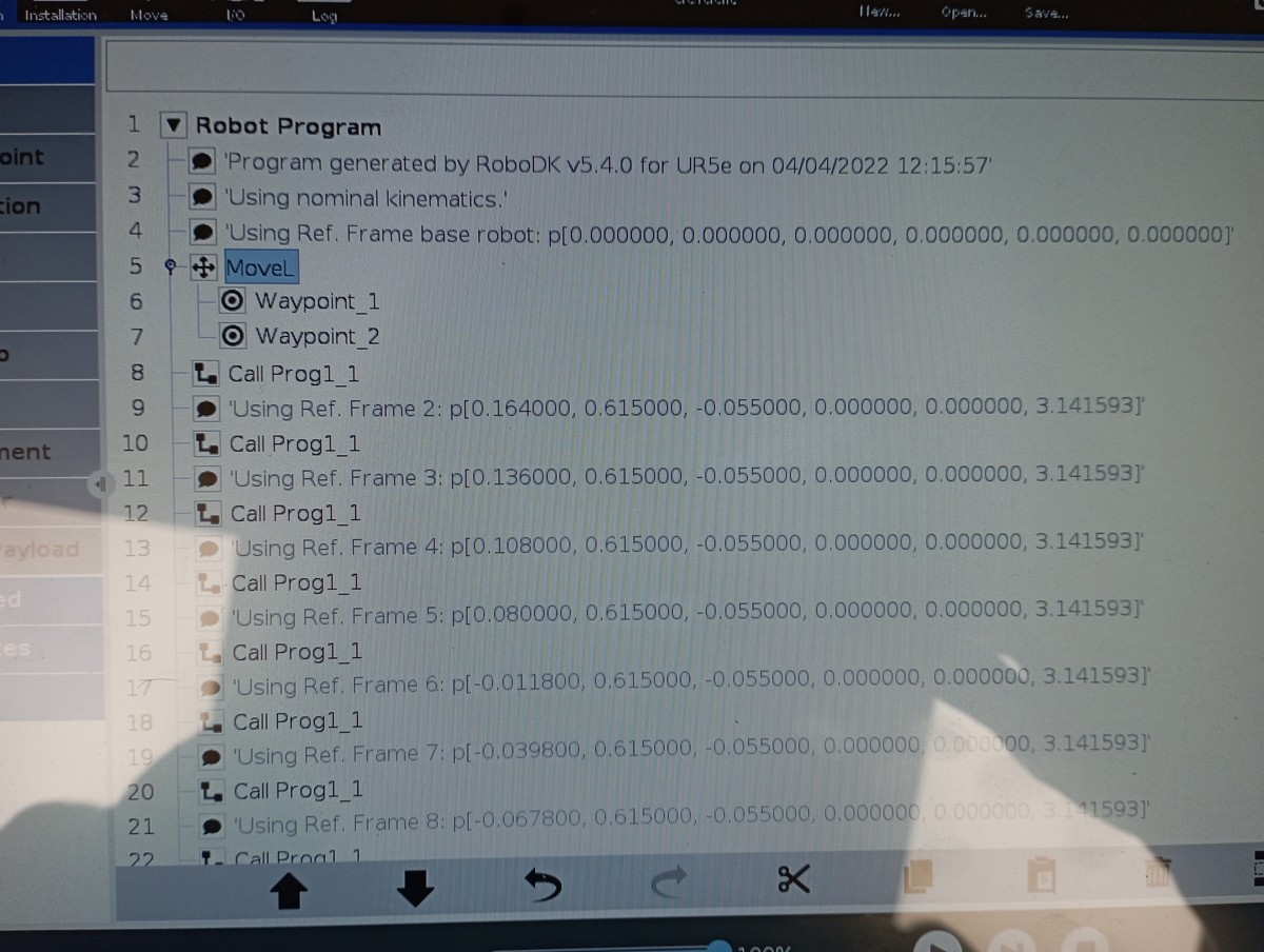

Still not working. It only works using the "Universal Robot" post processor instead of "Universal Robot URC". The problem is that with the "Universal Robot" post processor it generates a script for me instead of a ".ur" program.
Can you better explain the issues you have when you use the Universal_Robots_URP post processor?
You should see a script line set_tcp which should update the tool as you execute the program.

Can you be a bit more precise on exactly what doesn't work as it should? What are the behavior you are observing on the real robot.
I attached a picture of my program.   The function to change the frame before executing each "Prog1" is not recognized by my UR5e controller.
