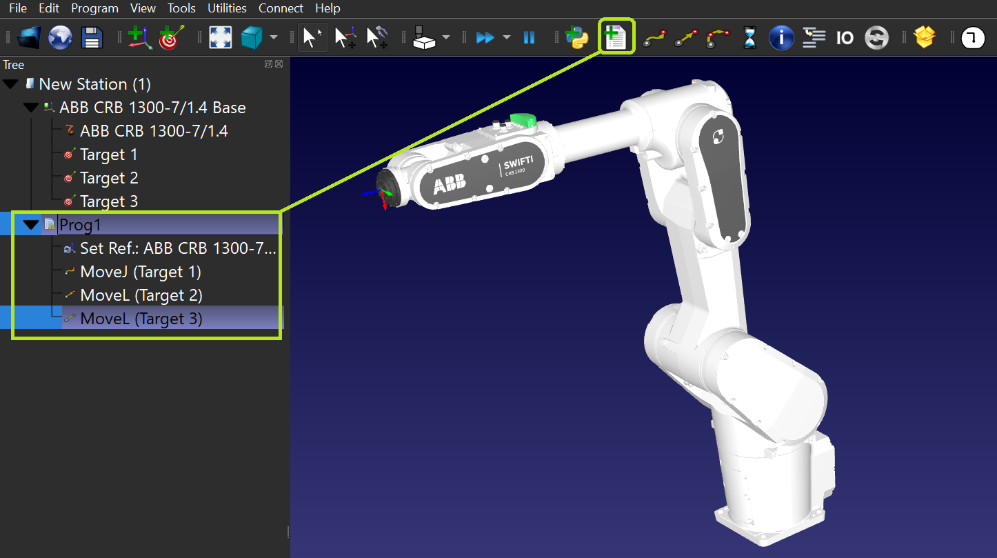

You can use the 'Add new program' instruction. Does this method allow you to generate programs?

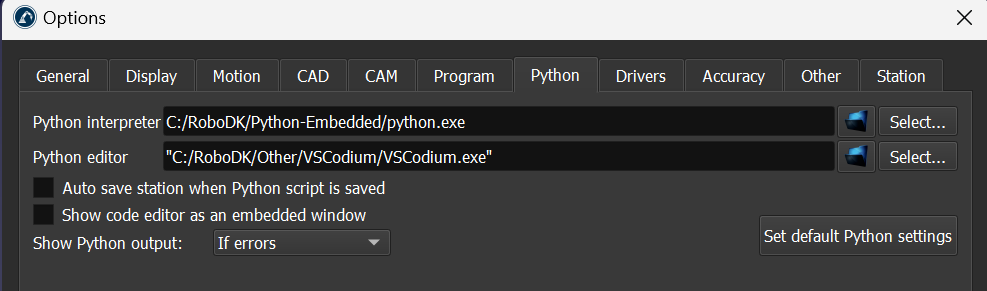

Could you please check what the Python interpreter used?

Yes, I can generate a robot program with the "Add new program" instruction, but not with a python program and my python interpreter has the same options than yours
