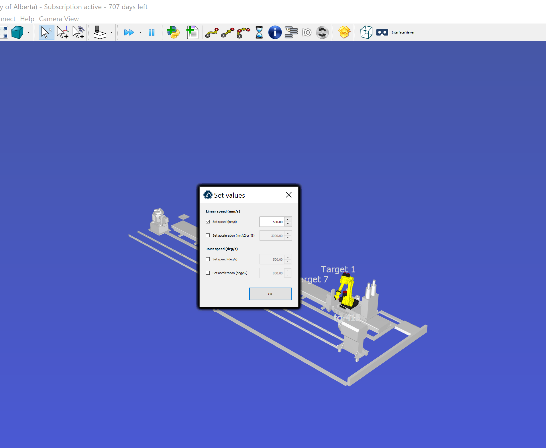

I am using the Python API and when adding a speed instruction to the program the window will still pop up although it is disabled as in
program.setSpeed(value, False)

So I solved the problem.
The issue was with the speed value, it was negative which is incorrect. But It would be better if the API would check the value first before it sends it to RoboDK, and throw an error in case of an unexpected value.
