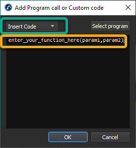

Yes, for that you need to know the exact "script" function you need to use.
Then you can add it as an "insert code".
This work directly in a program or using the program events of a curve follow project.

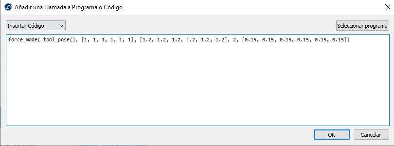

Hi Jeremy!
So... with this instruction at the beginning of the program, it would be enough?
I need my UR5e robot to stop if it detects a force greater than 1.2 Newton
Thanks you!!
Yes it should.
You might need to add a zeroing function before, but yes, you got the point.
Try it with a simple program, you will see your line of code appearing in the .script file.
