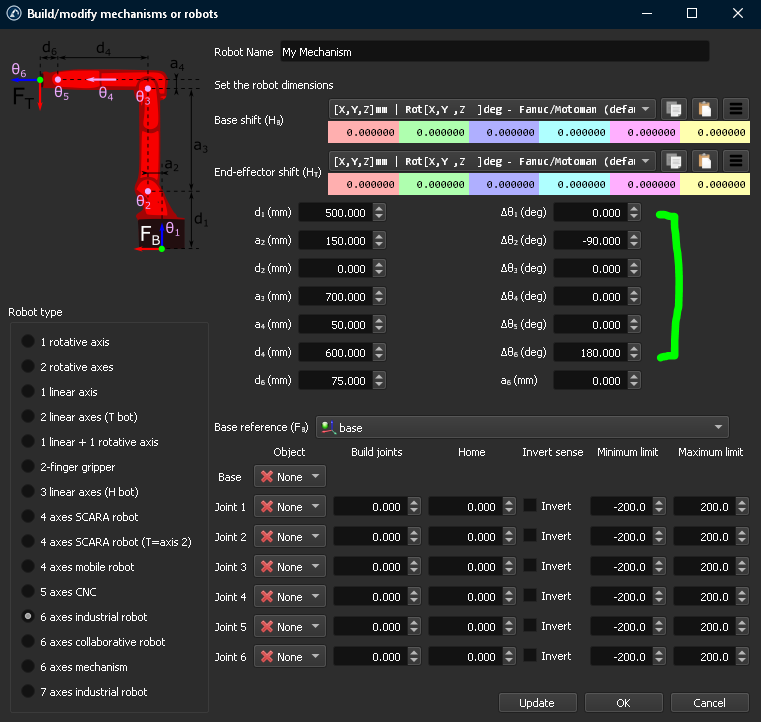

Hi how do you increase the number of significant figures when building a robot?
For the angles, 3 significant figures is not enough
Regards
We just published a new update that allows you to increase the number of decimal places for robot parameters when you create a new robot.
You can set the decimal places of your choice using this setting:
  1. Tools-Options-General
  2. Increase the Position decimal places to 5 or your desired value. This will apply to both distances and angles.
This update is available for Windows 64 bit only at this moment.
