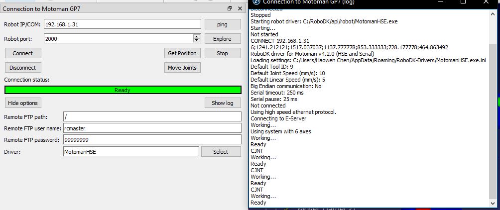

I've tried to test with the default robot program instead. It turns that the robot can execute the first instruction. Then the connection status will remain in working even after it has reached the target, so that it cannot proceed to execute next instruction.
Is there any solution to that?
