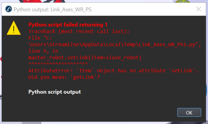

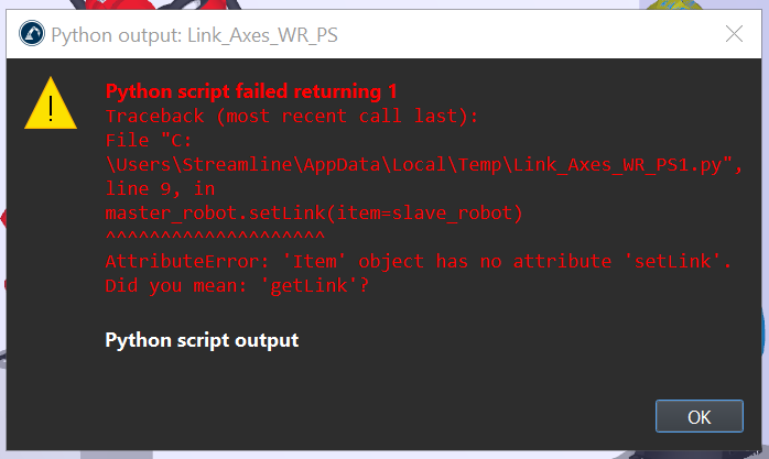

Hi Albert,
I added scripts to my station that are supposed to link and unlink external axes. However, I get an attribute error for setLink. The script is supposed to call setLink on the master robot. I can do this via the API, but whatever is interpreting the Python script is not recognizing the setLink attribute. I'm using Python 3.13 and RoboDK 5.9. Do you have any advice on how to get the scripts to work?
.rdk   script_test.rdk (Size: 5.09 MB / Downloads: 357)
I was actually using RoboDK 5.4. I just updated to 5.9 and the scripts work! Thank you. Sorry to bother
