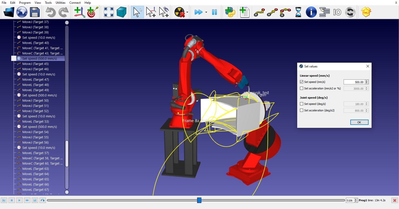

It is possible in RoboDK save speeds in some variables? Because when i have program with for example 50 welds and 50 movements and i want experiment with speeds to calculate possible welding time it is too much setup changes.

i just think speed variables in roboDK will be fine for check working time when customer ask me on his weldment how much time will be robot weld.
because it is possible welding with higher parameters with higher speed or lower parameters with slower speeds and we exmerimenting with this variables for our customers..
