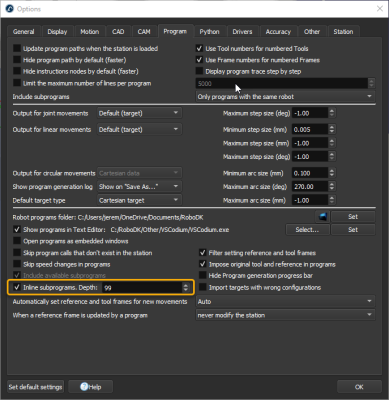

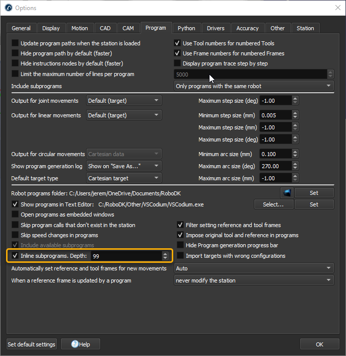

I am working with a robot controller who doesn't support program call, as far as I know, I was wondering if it is possible to change the post-processor so the main program include the subprogram  with no need to program call
Hi Ahmed,
Take a look at this option from the parameters ("Tools"->"Options"->"Program").
