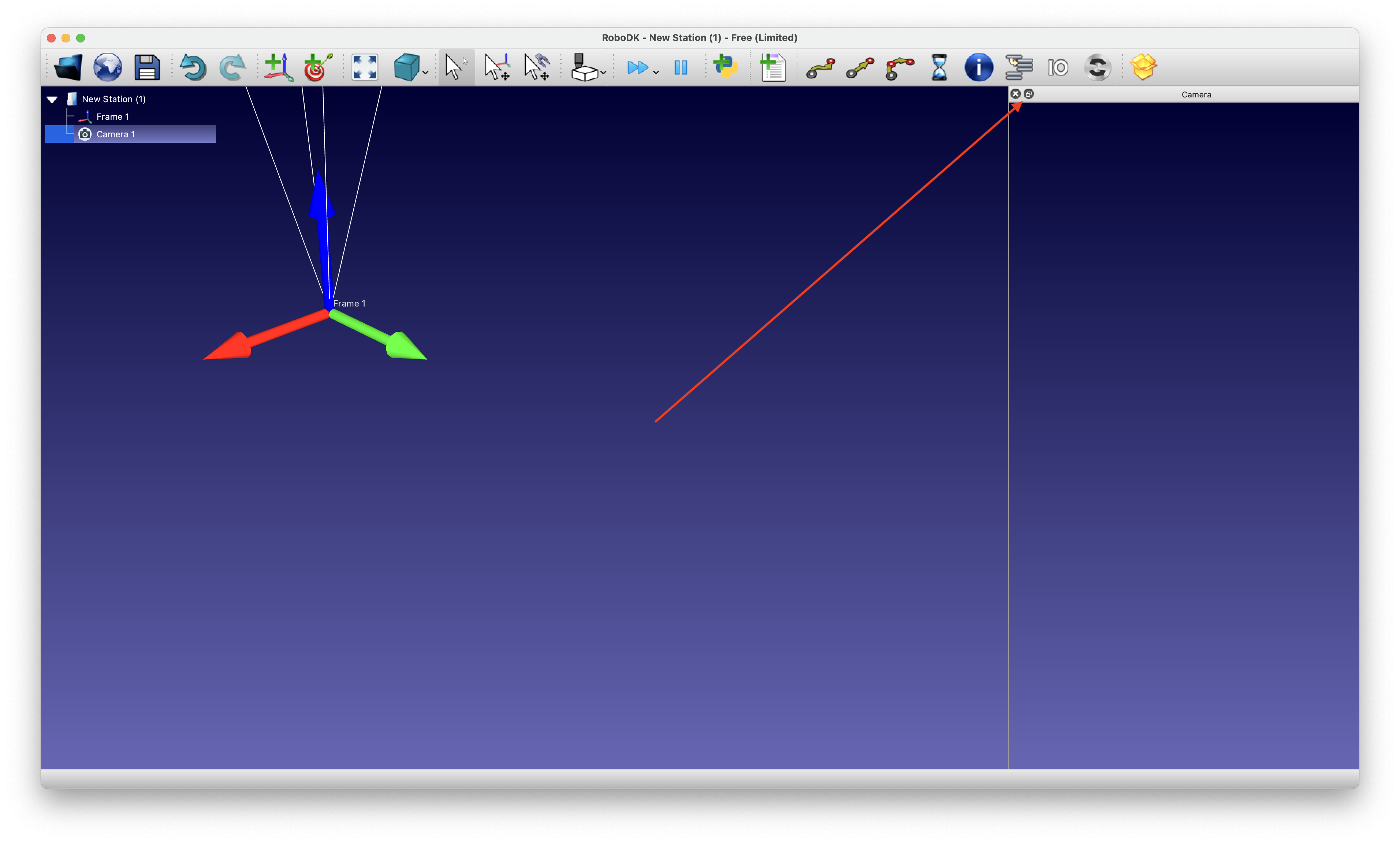

I have updated to the latest version of RoboDK, despite the fact that the md5 of the installer remains the same, DOCKED mode does work, but:
1) if I open the camera in DOCKED mode, then UNDOCK it, it opens in a separate window (as it should be), but if I close this window by pressing X, it causes the RoboDK to crash scr1.png    scr2.png

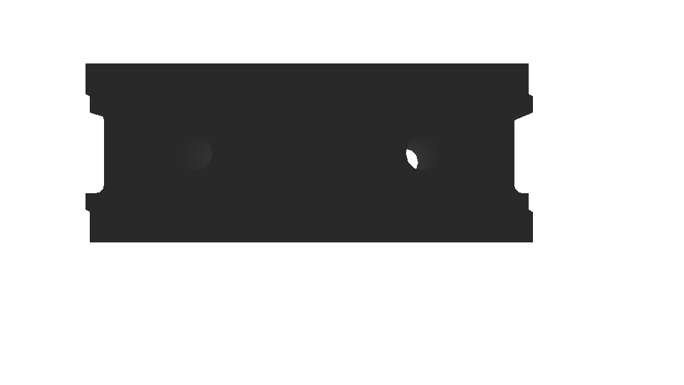

In both cases, the visualization matched what I see in the camera window in RoboDK (cropped image), but if I save the PNG in DEPTH mode, it doesn't look cropped🤔.
