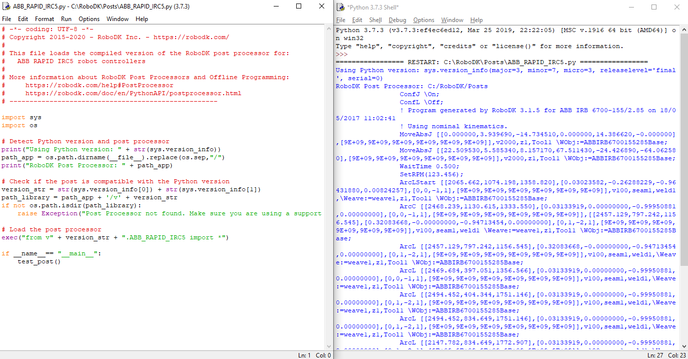

I am currently operating under the assumption that the easiest way to configure an extruder for 3d printing is by modifying the appropriate post-processor in order to define extrusion rates, analog out ID #'s etc. When I navigate to Program --> Add/Edit Post Processor and open the ABB IRC5 processor, I can only seem to access the following screen:
Upon browsing the forums, I came across this thread which seems to indicate that post processor source code is no longer included with RoboDK by default, and must be requested.
