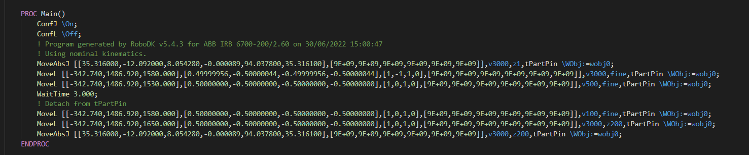

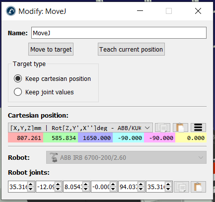

When "Generating robot program" for an ABB robot, MoveAbsJ moves are being downloaded instead of a Cartesian MoveJ, even when "keep cartesian position" is selected.

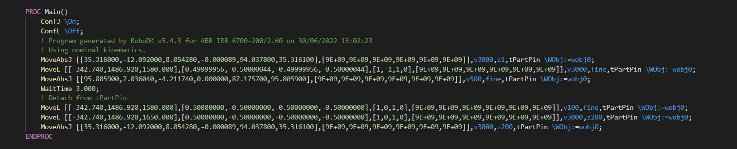

One more question regarding ABB downloads,
Why is ConfJ \On; ConfL \Off; downloaded at the top of the PROC? Is there a way to disable this? I can't see it in the Post Processor. I have "Resect joint turns for linear movements" selected in the motion settings. Thanks, Robert |
