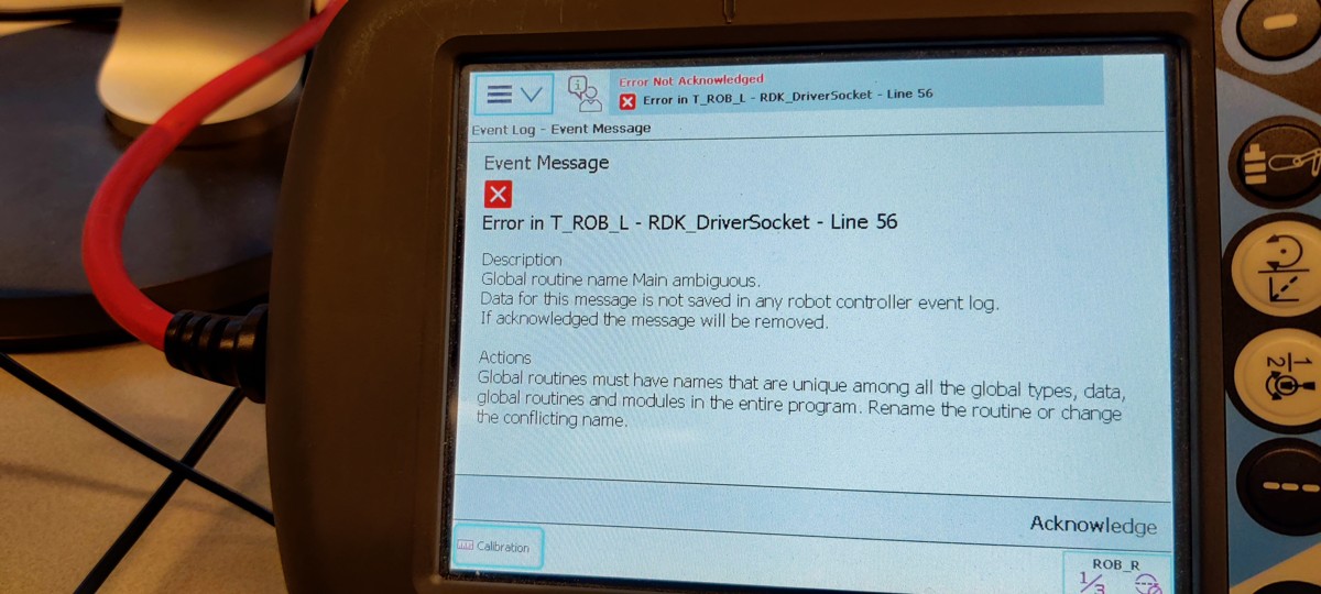

I am trying to connect to IRB 14000 through ethernet cable to move the robot automatically from a connected PC using RoboDK. Do i need to load the RoboDK driver module for ABB robots onto to the IRB 14000 first?

 I did exactly as it said in the documentation. However, when i try to run it as the main program, I get an error message on the FlexPendant. (see Image)
 Do you have any idea how to solve this?
Sorry please oblige as I am new to RAPID programming.
Hi Kratos,
The error message seems to suggest you have move then one "Main" program on the controller.
Is it possible?
Are you using the Yumi with dual-arm or the model with only one arm.
