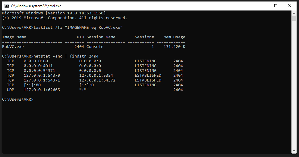

I hope the files are correctly attached now. I tryied with localhost and IP 127.0.0.1 and I looked at which port we can connect to robotstudio by netstat in cmd. I am guessing it was port 5354. But roboDK can not connect. Maybe, I am doing something wrong.
