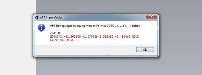

How did you generate this file?
Make sure to generate generic 5 axis code including ijk tool vector.
This file looks for a specific 5-axis CNC and a specific configuration.
Posts: 2
Threads: 1
Joined: Jun 2020
Reputation:
0
Hi Albert
First of all thank you for your quick answer ............
I am using Mecsoft Visualcam to generate this file ( Postprocessor File APT CLS IJK ) ...........
