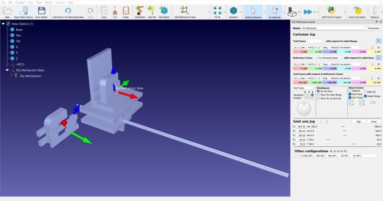

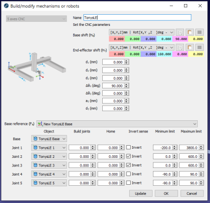

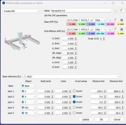

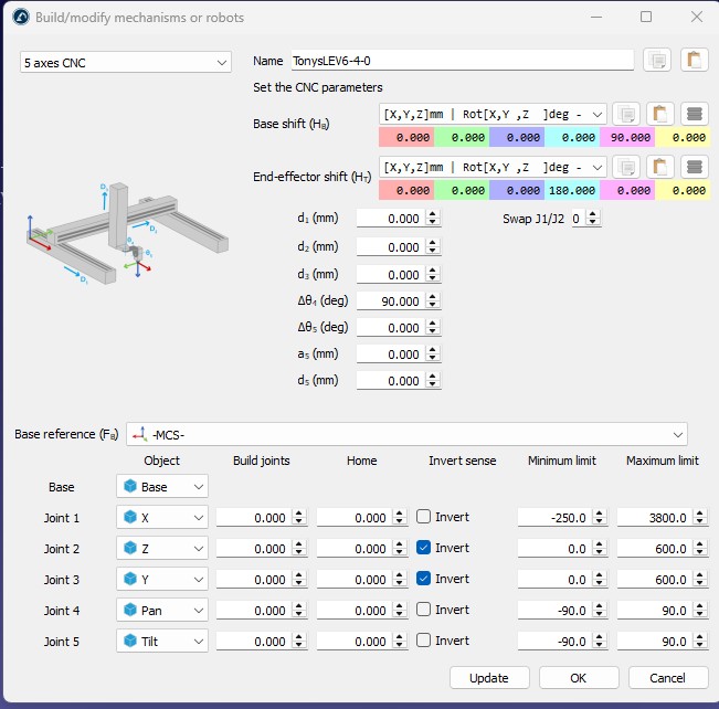

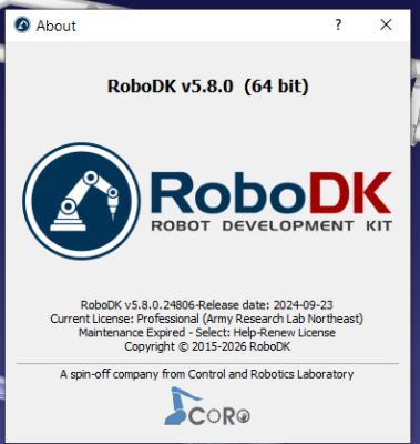

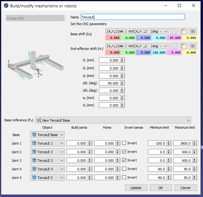

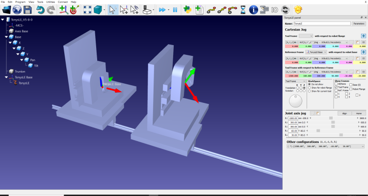

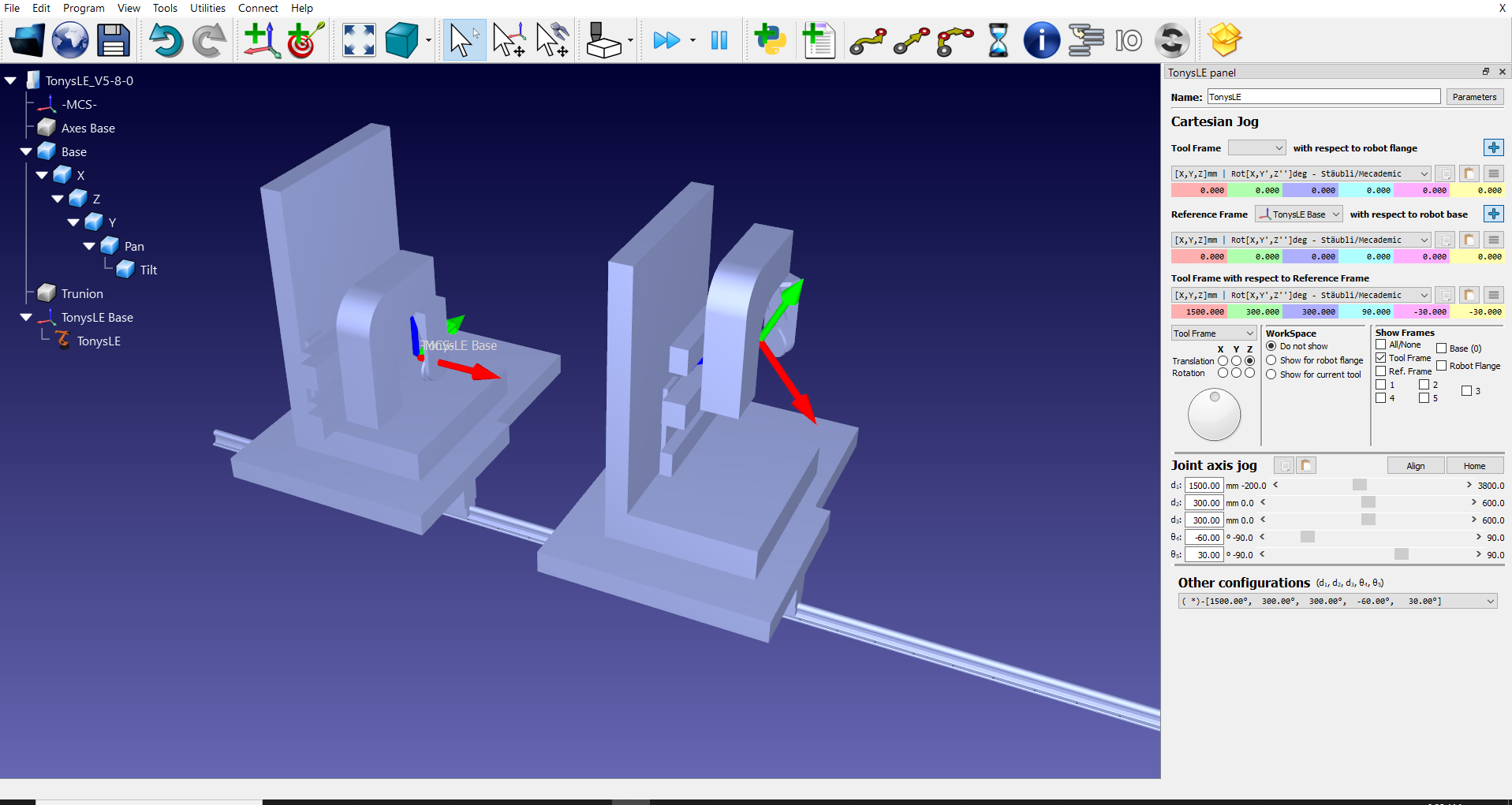

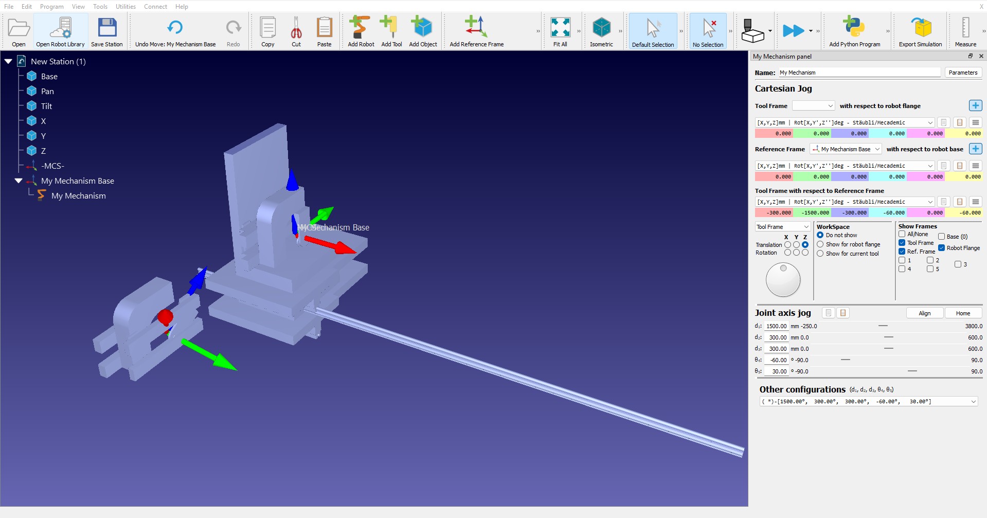

I may have found a bug with the Build Mechanism function in V6.0.4. I can correctly preview the motion when building my mechanism, after I press ok, the CAD objects I have selected change, e.g. my x motion statge becomes the y motion stage, and the directions are incorrect. I have tested the same CAD data and the same settings on version 5.8.0, and the motion and CAD are correct.
Attached are the files I used for testing, and photos of the errors.
Correct motion and cad v5-8-0.PNG    Mech build settings 5-8-0.PNG    RoboDKV5-8-0.PNG    Mech Build Settings V6-4-0.jpg    V6-4-0 incorrect motion.jpg    V6-4-0.jpg

When you are building the mechanism it offsets by 1000 mm by default to make sure you don't preview the movements of the mechanism in the same area of your 3D models.
Also, the base frame rotates around the Y axis by 90 deg by default. You can set this to zero if you prefer to match exactly with your DHM table.
Thank you for response. My apologies for the same topic in two forums. I understand the base shift, resolved thanks.
Yes, this mechanism has a 90° Ha base shift in the Y-axis to create the correct movement. The issue is the preview motion and CAD does not match after 'OK' is pressed. With the settings above, the preview motion works in version 6.0.4 and 5.0.8 however with version 6.0.4, the motion stage changes X stage becomes the y stage, and the direction of travel changes from x+ to y-. this error is not present in version 5.0.8. I was able to successfully create the mechanism in 5.0.8 and load the mechanism in 6.0.4 but I cannot create the mechanism in 6.0.4.

On the latest version of RoboDK you'll find a flag called Swap J1/J2 which changes the order of the axes 1 and 2. Maybe this is what you are referring to? Otherwise, there is also an option to create a custom generic 5 axis mechanism.
