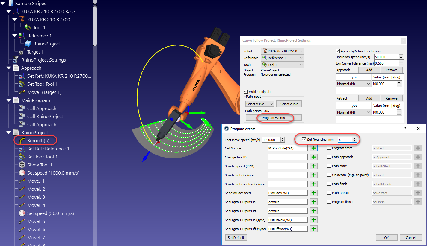

  • Change auto program from type Linear to PTP, Arc circle. Because type linear affects the actual running speed down of the robot.
  • I can’t change numbers path point in program. Is there any way to change number point?(please check attach)
I believe you want to to use rounding/blending option to speed up the robot and also avoid jerky movements. See attached image to enable this option.
More information here:
https://robodk.com/doc/en/Robot-Programs.html#InsSmooth
You can also reduce the number of points per program here:
Tools-Options-Program-Limit maximum number of lines per program.
This will split long programs in subprograms (one subprogram in each file) so that you can easily run it on the robot.
Thanks Albert,
I know why my robot low speed: main program set speed 1/20 speed of robot and disable set rounding.
