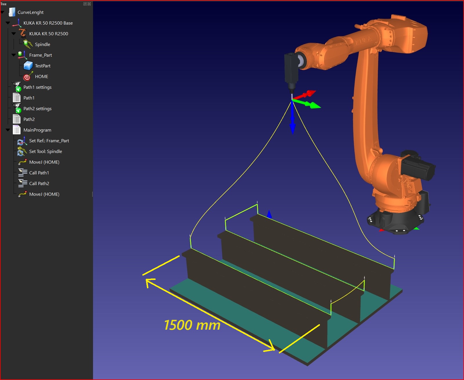

is there a way to find the length of one or more curves within a curve follow project? It should exclude the lengths of approach, retract, or idle paths. I only want to see the total length of the actual processed surface.

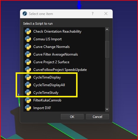

In the example I provided, the length of a single path is 1500mm. In reality, the total length of the processed surface should be 4500mm, but when I use CycleTime scripts, it doesn't give me what I want.
