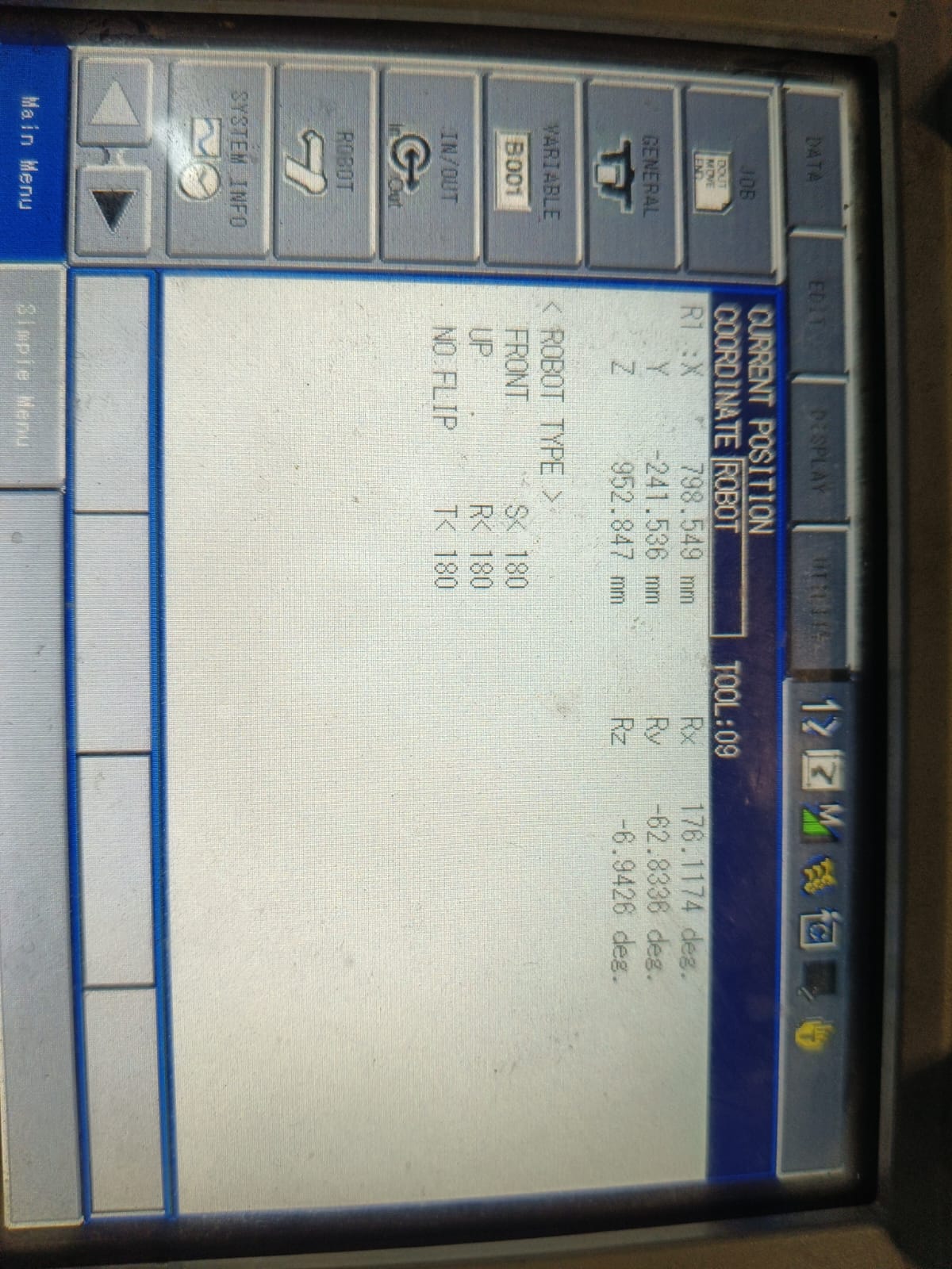

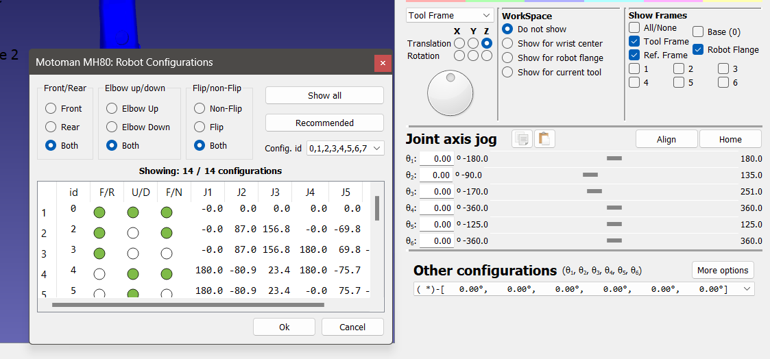

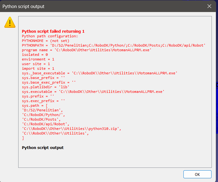

i wanna update pulse/degree of my robot, MH80. i followed these instructions,  https://robodk.com/doc/en/Robots-Motoman.html#Motoman. but, when i drag and drop file ALL.PRM, it couldn't happen as like that and appear python error. could you help me with this? and I want to set configurations of the robot in the menu "other configuration". in more options, I set it in configuration Front-Elbow up-Non flip. but, it cannot save the configuration as I want to. do you know how to set the configuration
This issue has been fixed with the latest version of RoboDK when using the default settings.
Are you using the latest version?
yes, im using the last version robodk
Are you using the default Python settings in Tools-Options-Other?
Feel free to send us your ALL.PRM file and we'll update the robot model for you­.
yes, i use default setting and not change anything. here I attached my project and the ALL.PRM
and this is the configuration i want to adjust to MH80 in RoboDK

I just loaded the ALL.PRM file in your project.
.rdk   base station-v2.rdk (Size: 5.42 MB / Downloads: 566)
