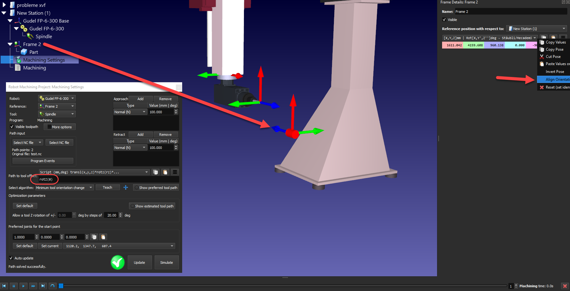

This robot machining menu was mostly designed to work with 6 axis robots. You can still make it work with a 3 axis CNC or a custom mechanism if you properly define the orientation of your coordinate system to make the path feasible.
Also, in the project you sent, the coordinate system is outside of the machine workspace and this is why you see the message about the first point not being reachable.
See attached image and RDK project with the changes I made.
.rdk   CNC-Machining.rdk (Size: 460.87 KB / Downloads: 996)
