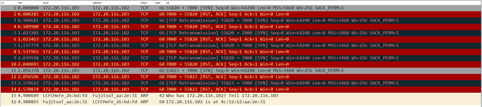

My computer is directly connected to the controller using ethernet. The IP addresses of both the controller and my computer have been set manually. My computer is 172.20.116.103 and the controller is 172.20.116.102. I get the following message when I try to connect:
Quote:Sending command...
Trying connection
172.20.116.102:7000...
Not connected
I monitored the connection with Wireshark and get the following messages:
Any idea what could be wrong?

It is working today! I don't think I changed any settings since I last tested it yesterday, so I am not sure what fixed it.
