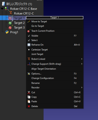

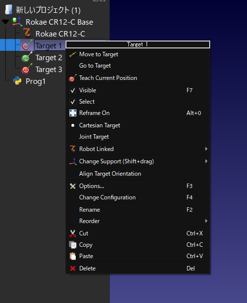

Can I set RoboDK to use MoveJ instead of MoveL when I right-click a target?

How can I change the default motion command from MoveL to MoveJ when right-clicking a target in RoboDK?

There is no default motion for a target. Instead you should use a Joint movement instruction or a Linear movement instruction depending on what you are looking for.
When you select multiple targets and choose to create a program automatically using the "Create Program" option, RoboDK automatically prepare a joint movement to the first target you selected and then linear movements to the other targets.
In RoboDK, targets can be defined either as joint targets (in joint space) or Cartesian targets (in Cartesian space). When moving to a target, you can choose to move using a joint movement (MoveJ) or a linear movement (MoveL).
