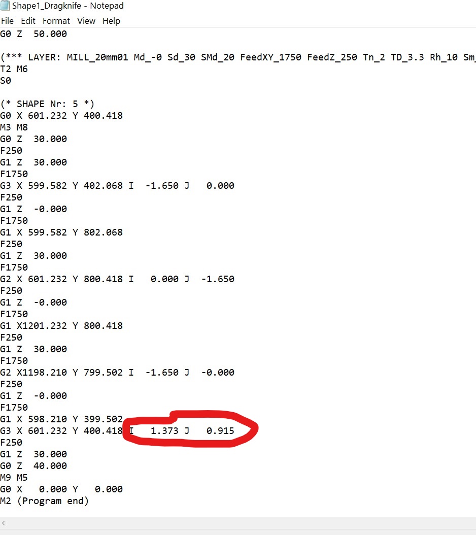

The dragknife setting works perfectly until the end of the last move. For all the other moves the tool direction is changed to the cutting direction at the safe height or extraction height, and then only the Z move is done into the stock. At the end of each move, the tool lifts up, changes tool direction to next cutting, moves down and start cutting. HOWEVER, at the end of the LAST move the tool direction rotates whilst it is still in the stock. This is a big problem for a Circular blade tool.
I have noticed in the NGC file attached that the rotational move is created by DXF2Gcode.
Please advise if there are ways to automatically remove the last rotational move? Or if there are any other ways?
