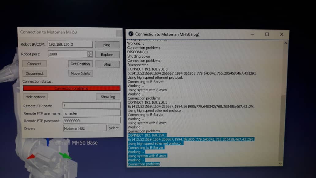

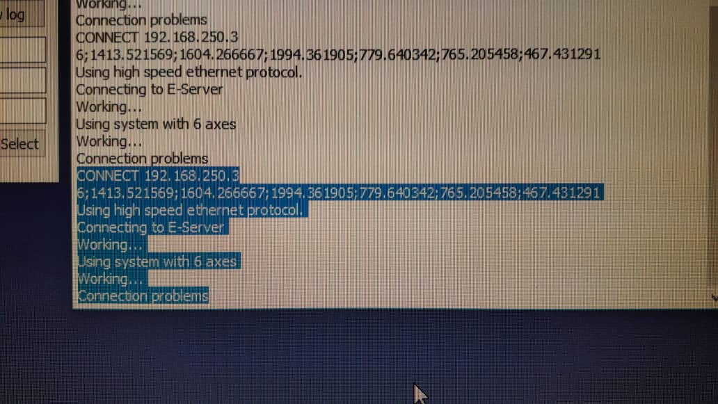

I will connect Yaskawa MH50 to RoboDK software but it have error in communication. Can you help and say what is problem and how can solve it?
.jpg   IMG-20200303-WA0001.jpg (Size: 42.87 KB / Downloads: 643)
.jpg   IMG-20200303-WA0000.jpg (Size: 79.49 KB / Downloads: 621)
Can you try to do the same test using the debug option?
You can activate debug output by following these steps:
  1. Open the file C:\Users\UserName\AppData\Roaming\RoboDK-Drivers\MotomanHSE.exe.ini
  2. Change Debug_Print to true as shown in the following image

Can you contact us directly through our contact form with this information to solve this issue.
