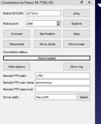

What setting do you have as Driver path? (in Connect-Connect to robot-More options)

I cannot take a video of the teach pendant, because nothing actually happens except that Roboguide freezes. Here is the connect configuration and my project. Thanks
