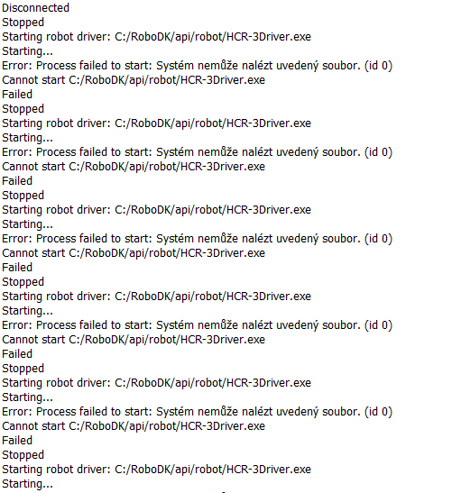

I am unable to establish connection between HCR robot and RoboDK.
Does anyone know if it is it possible to connect RoboDK with HCR robots (HCR-3, HCR-5 or HCR-12)?
I noticed, that when connecting to the robot, the default driver used is called HCR-3Driver, but there is no such file in RoboDK directory.
I attached screens from RoboDK

As far as I know, we don't have a driver for the HCR robots.
In most cases, a driver is not your best option to program a robot offline.
You should use the post-processor to generate code and load it on the controller.

Offline programing works for HCR robots just fine (apart from rounding instructions). We already did few aplications using that.
Now i was trying the online programing (I needed to adjust robot position in roboDK according to physical layout of the workspace without creating 3D model).
Do you plan to create HCR driver, or is that something that i should contact the HCR manufactuer for?
