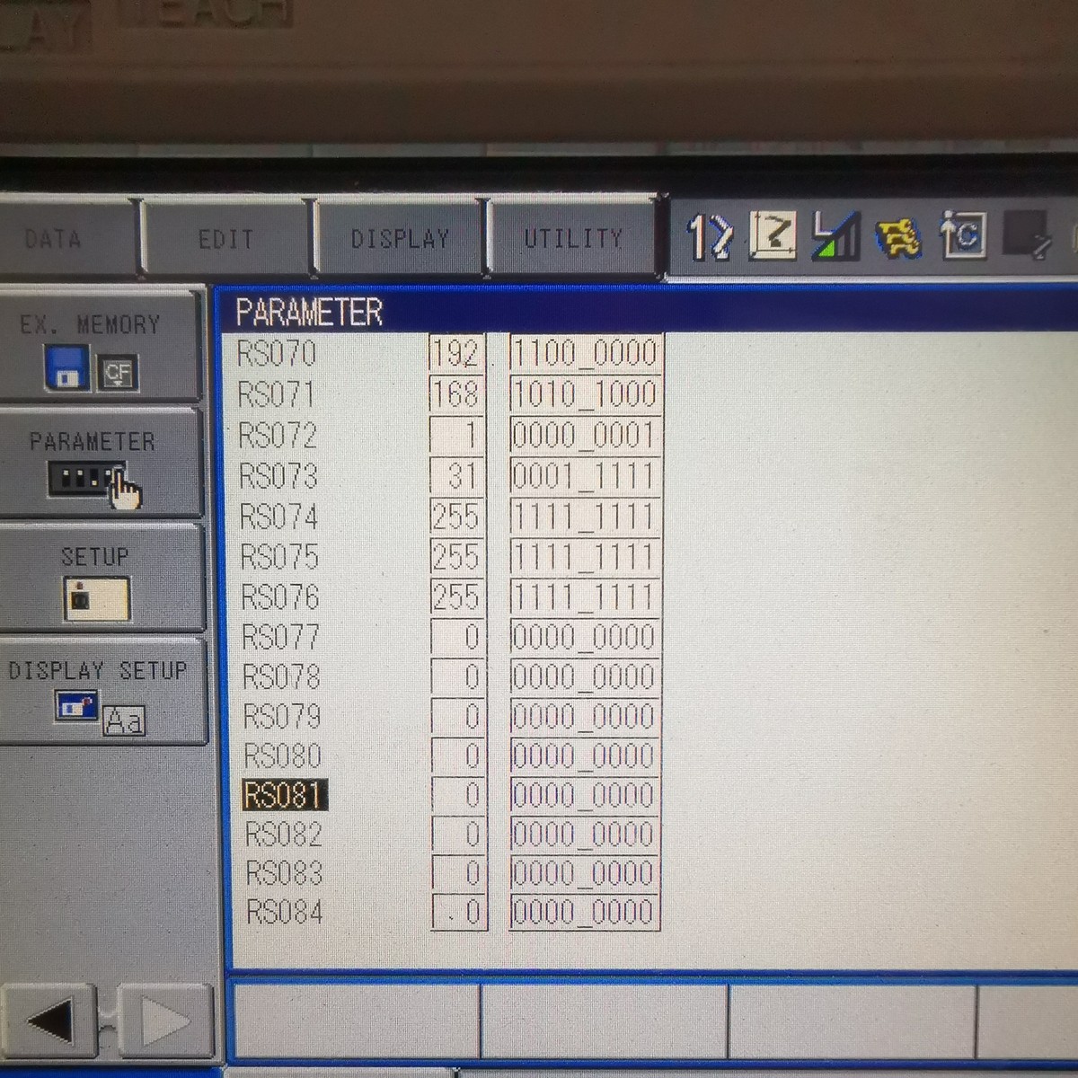

I still have a problem with the connection between RoboDK and the Roboter.

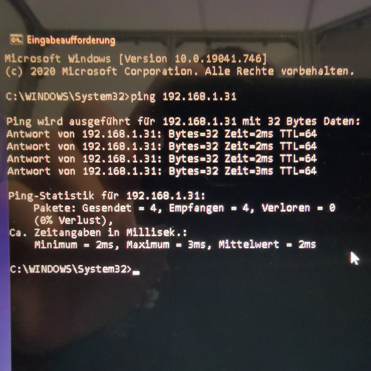

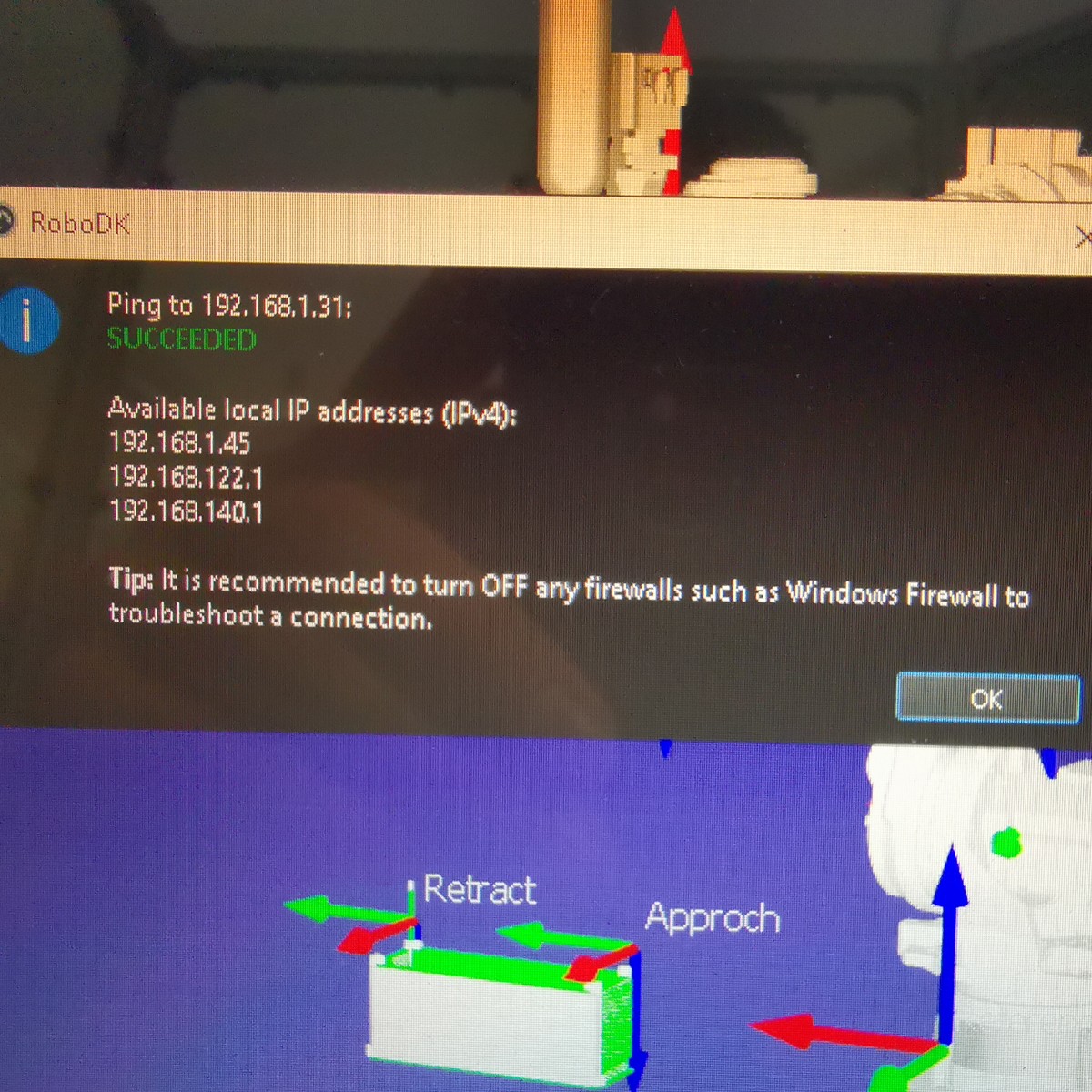

As you see in the photos, the Ip address of Robot 192.168.1.31, and for my computer 192.168.1.45.

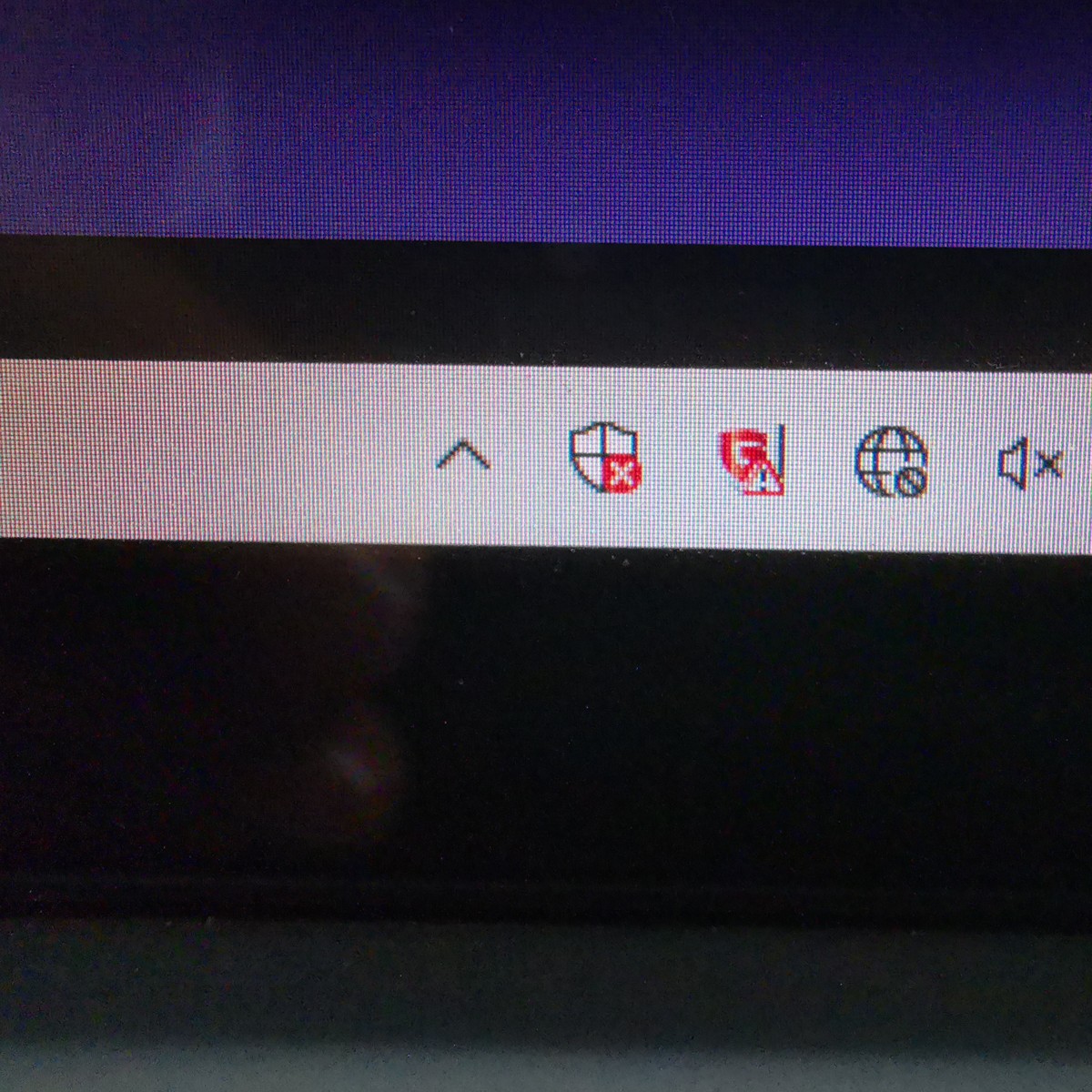

Pinging is OK. all firewalls are deactivated.

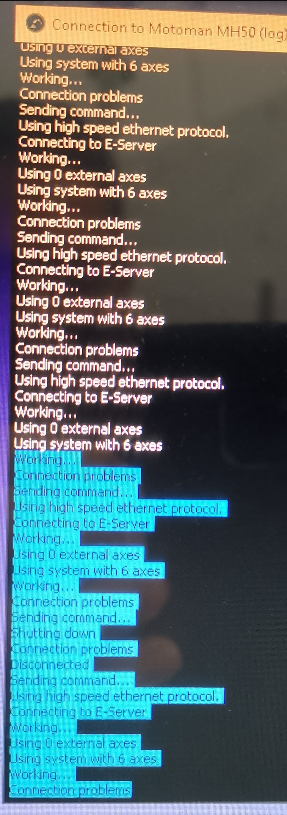

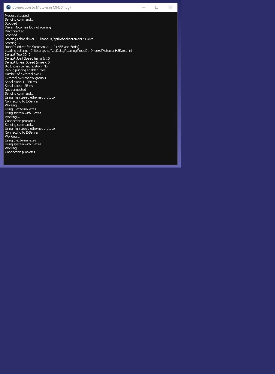

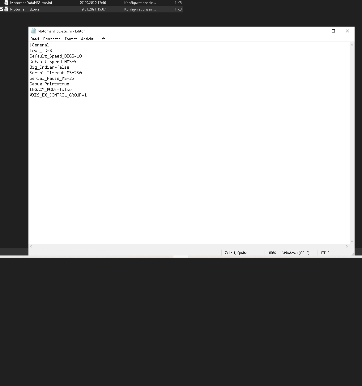

Hello, you said you turned Debug_Print=True so I assume you know how to edit the config file, could you post a screenshot of the begining of the driver log, you can completely reset the driver by double clicking disconnect in the connection panel.
Hi Philip,
Please find the attached files. I hope I posted the write one ;-)
Thank you
It appears the controller isn't responding to initial request to make sure the robot exists, do you know what controller your using with the robot? (DX100,DX200,YRC1000,etc)

Reading manuals for motoman robots I see a note that the serial communication needs to be disabled for ethernet communication to work, this is done by setting parameter FD077 to 1 and FD078 to 1. Can you verify the value on the controller?
