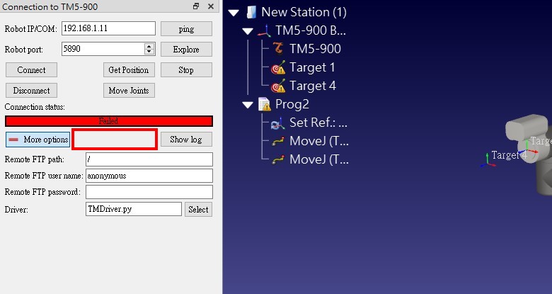

I already try the step you mention, but it still doesn't work.
I also refer to the video which is release on your youtube channel.
https://www.youtube.com/watch?v=2TJD1YyU...27&index=8

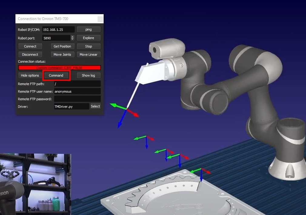

But I found a few different points:
1. I do not have a command button
2. My TMdriver.py has a different storage size than the video, Mine is 2kb, Video's is 41kb.
The attached video is my operation, please check if there has some mistakes.
Thanks!
