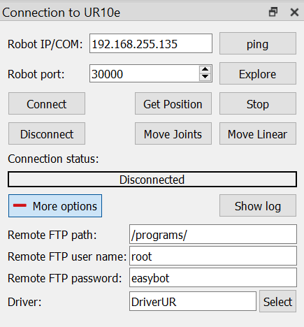

I have the latest version of RoboDK and a UR20 cobot. I am trying to connect with robot and while it pings the ip adress it cant connect with the robot as it shows me this log report:
Error: Process failed to start: The system cannot find the file specified. (id 0)
Cannot start C:/RoboDK/api/robot/apiur.exe
Failed
When I try to send a program to the robot it runs fine in the real world but without the connect i dont have the options to move the joints or to match the position o.
Thank you
We have updated our driver and it is now called DriverUR. Try clicking More options and changing the Driver field from apiur to DriverUR.
