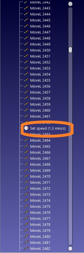

We have generated a NC-Code with Solidworks.
Now I am looking for a solution to maintain the speed continuously.
The value of the SetSpeed changes a lot and I would like to continuously maintain constistens speed.
My questions/guesses about this:
Is RoboDK doing this over the postprocessor ?
Is it related to the path direction or curvature ?
Is there a setting for setting a fixed value and no need to correct each SetSpeed individually ?
Thanks
If you start from an NC file, the speed changes are part of the NC file, so SolidWorks is responsible.
You can prevent those from being part of the end program by selecting "Tools"->"Options"->"Program"->"Skip speed changes in program".
