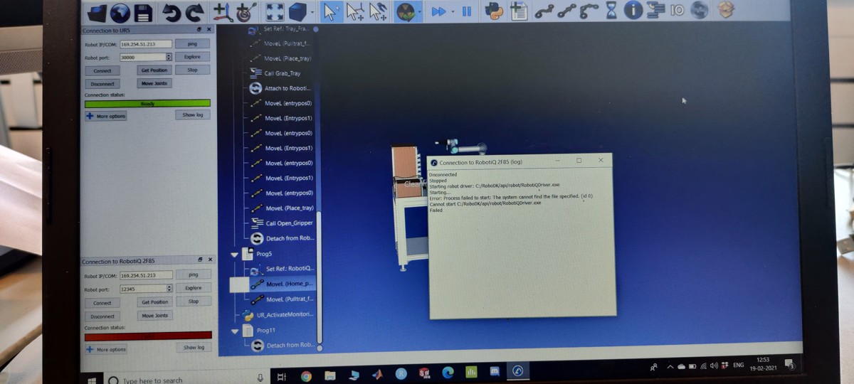

Hi Jeremy,
I am trying to connect to Robotiq 2f-85 gripper through robodk but I get a failed connection. I have attached an image of the log file.
Regards,
Kratos
Log_Robodk.jpg    Log_Robodk.jpg    Log_Robodk.jpg    Sorry, Here is the image.
Oh,
You won't ever be able to connect to the gripper that way.
That would require a driver that doesn't exist for the moment.
Using the Universal Robots Robotiq post-processor will only affect code generated from RoboDK, not the live connection.
