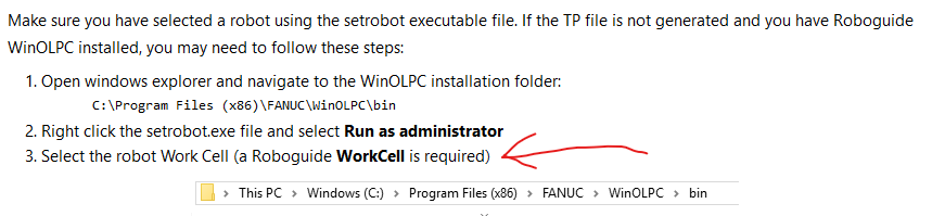

Hello everyone. please can anyone help me? i have a probleme that when i save my program from RoboDK it always save it as LS and i can´t see it when i try to put the programm in my usb stick and load it it the Robot controler.
Please how can i change it to a TP file? Thank you so much
