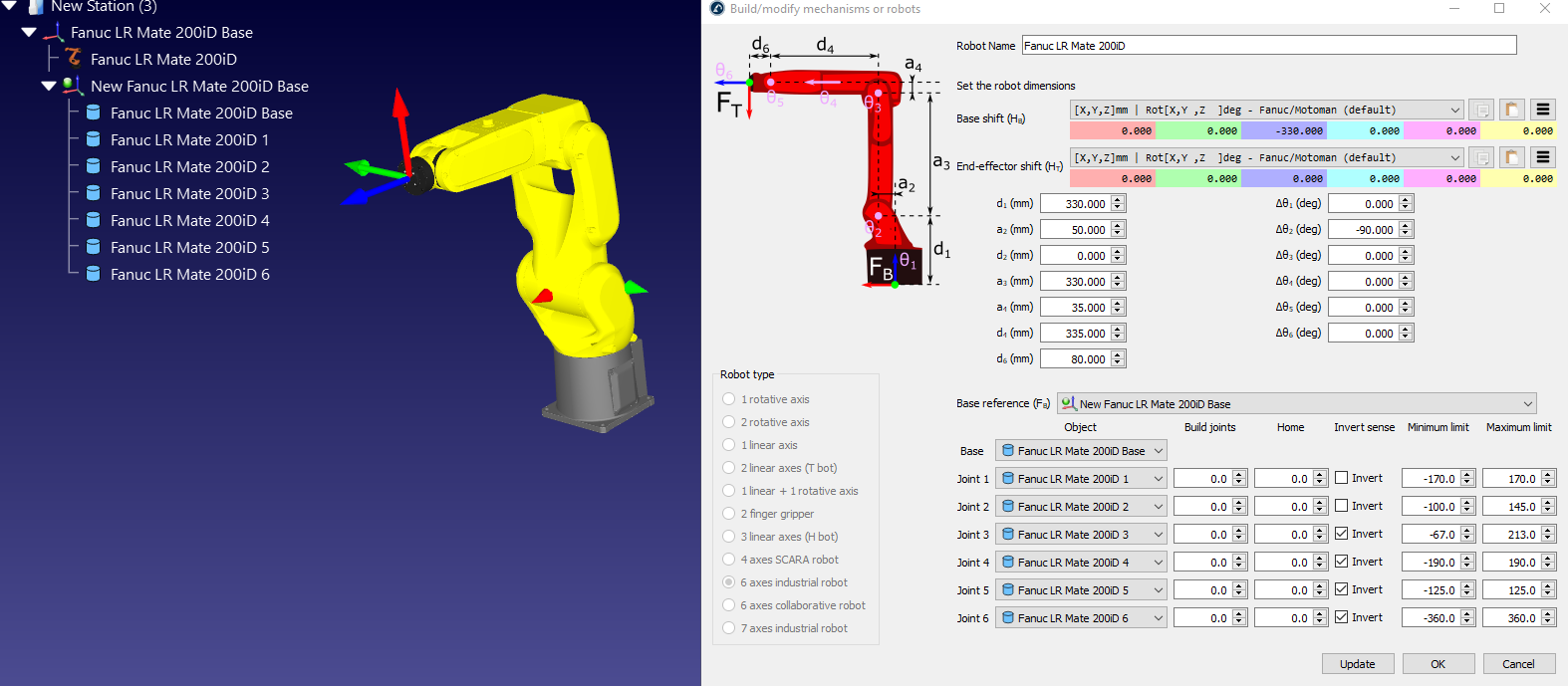

I took a look at your file but the robot parameters are missing. This is the most important part as they represent the robot kinematics. These are the parameters must be provided as a list of values in the same order they appear in RoboDK's user interface when you build a robot or mechanism. RoboDK will automatically build the DH table based on these parameters. Some simple mechanisms (such as 1 or 2 translation/rotation axes) don't need these parameters because it is assumed you'll translate/rotate around the Z axis.
I attached your example working for your Fanuc LR Mate 200iD robot.

parameters = [330, 50, 0, 330, 35, 335, 80, 0, -90, 0, 0, 0, 0]
# Define the joint sense (set to +1 or -1 for each axis (+1 is used as a reference for the ABB IRB120 robot)
joints_senses   = [+1, +1, -1,  -1, -1, -1] # add -1 as 7th index to account for axis 2 and axis 3 coupling

The script crashes if the objects you retrieve don't exist. Make sure these objects exist (robot base, J1, J2, etc, must be available in the RoboDK station).
The latest version doesn't have this crash.
