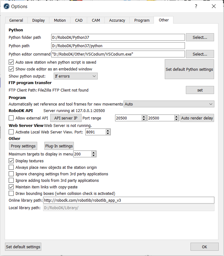

I tried sending the robot the code and got a python error.  Is there a tutorial on how to set up the FTP server? I haven't used that before.
Best, Austen
#12
Hi Austen,
The point in the middle of the line probably comes from your curve in Rhino.
What Denso controller do you have? Most modern robot controllers have a default user name and password you can use to connect via FTP.

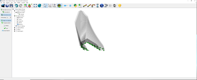

I have figured out most of my issues with programming and moving and had a few successful prints.  I am now trying to program a part that has ~200 curves and I am running into the screen using a "clipping plane" and cutting off parts of my setup. I have my setting set up for best performance under the display.  I have a 24 core processor and an RTX 3080 TI graphics card, I should not be limited on my computer side. Do you have any suggestions?  I have tried turning off my extruder, table, and robot to see if trying to process would be easier and it hasn't helped.
Best,
Austen
