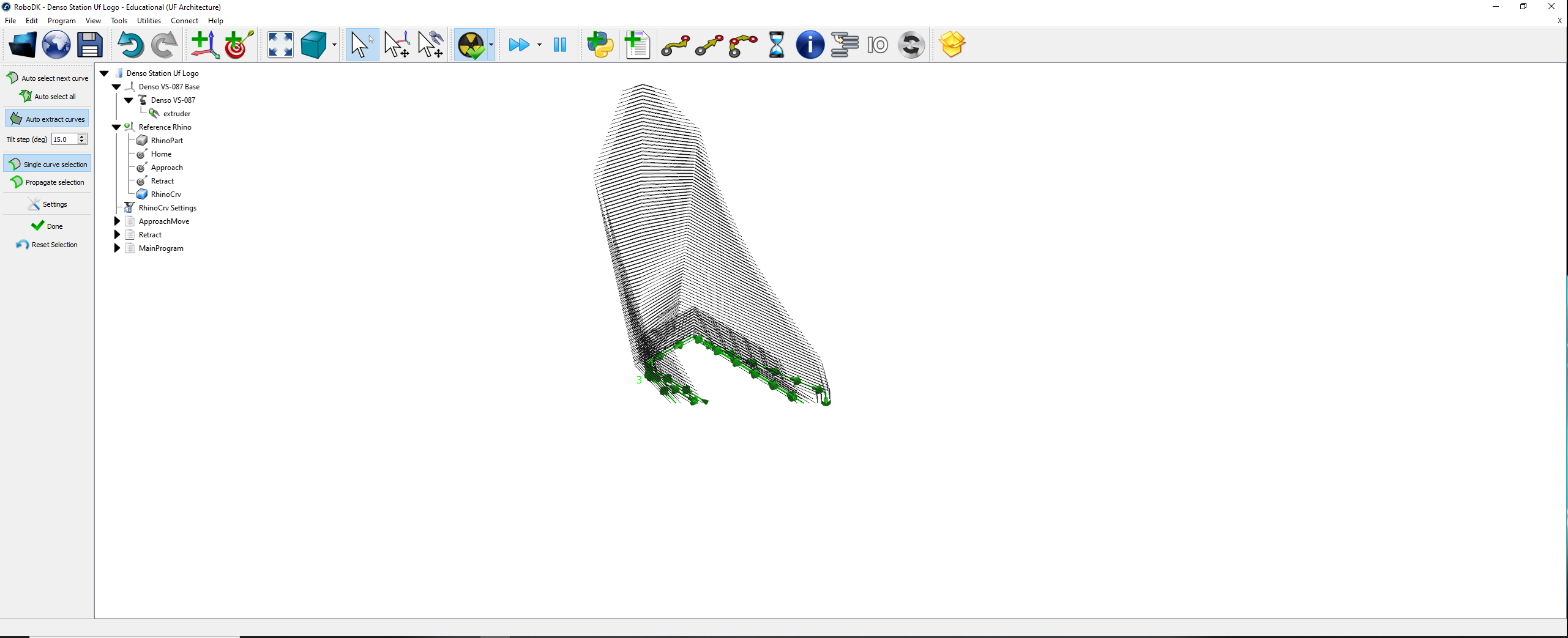

Hello @Oliver @Albert
I have figured out most of my issues with programming and moving and had a few successful prints.  I am now trying to program a part that has ~200 curves and I am running into the screen using a "clipping plane" and cutting off parts of my setup. I have my setting set up for best performance under the display.  I have a 24 core processor and an RTX 3080 TI graphics card, I should not be limited on my computer side. Do you have any suggestions?  I have tried turning off my extruder, table, and robot to see if trying to process would be easier and it hasn't helped.
Best,
Austen
.rdk   Denso Station Slip joint test.rdk (Size: 17.93 MB / Downloads: 576)
