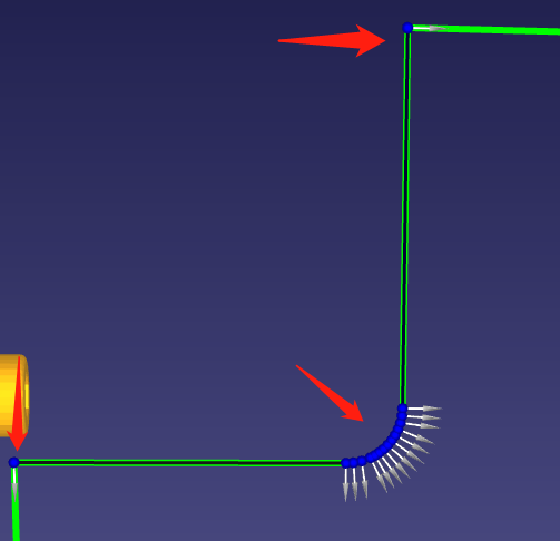

The exported Fusion 360 curve is not normal to the surface. The following are my settings:
Above is the imported curve from RoboDK. There are only 3 points for exported Fusion360 curve, and its direction is not normal to the selected surface.
Am I missing some settings? Or, is this a Fusin360 Plug-in bug?

Since it is a small fillet, I suggest you lower the Linear Tolerance value in the Polyline Curve Setting to 0.01mm.

(04-21-2021, 06:16 PM)Olivier Wrote: Since it is a small fillet, I suggest you lower the Linear Tolerance value in the Polyline Curve Setting to 0.01mm.
The curve direction are still incorrect. They are not normal to the selected faces. Should I update some RoboDK settings?
Fusion f3d file is attached. Please help clarify if you can have curves normal to the faces for this file.
